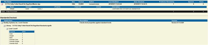

Disable "StandardsChecked" section from Standards Checker Report
User: I don’t want to present "StandardsChecked" section since there are too many levels.
•  Take a backup of "standardschecker.xsl" file
   C:\ProgramData\Bentley\MicroStation V8i (SELECTseries)\WorkSpace\System\data\standardschecker.xsl
•  Open "standardschecker.xsl" file
•  Locate the following line
   <xsl:apply-templates select="/StandardsCheckerReport/StandardsCheckerApps"/>
•  Comment this line to remove "StandardsChecked" section from the report.
