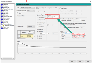

Direction Factor (f1, f2 and f3) for Response Spectrum load case for IS 1893(Part-1)-2016
 Product(s):STAAD.Pro
 Version(s):All
 Environment: N/A
 Area: STAAD.Pro Analysis Solution
 Subarea: Response Spectrum Analysis
 Original Author:SANJIB DAS, Bentley Global Technical Support Group
The direction factor for IS 1893(Part-1)-2016 Response Spectrum load case should be the value of (Z/2 * I/R). Z is the value of direction factor, I is the value of importance factor and R is the value of Response Reduction factor.
It must be provided in X, Y and Z direction if used in load case. The default value of this factor is Zero.
