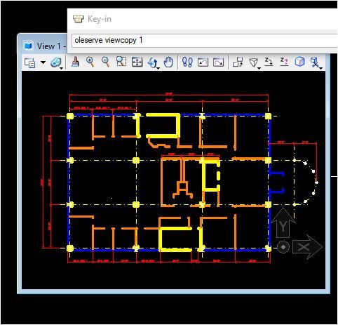

1) From the dgn file, set view of the desired elements
2) Key in: OLESERVE VIEWCOPY , then select view
           Or OLESERVE VIEWCOPY (n) ……n is view number 1 or 2 …(e,g key in: OLESERVE VIEWCOPY 1)

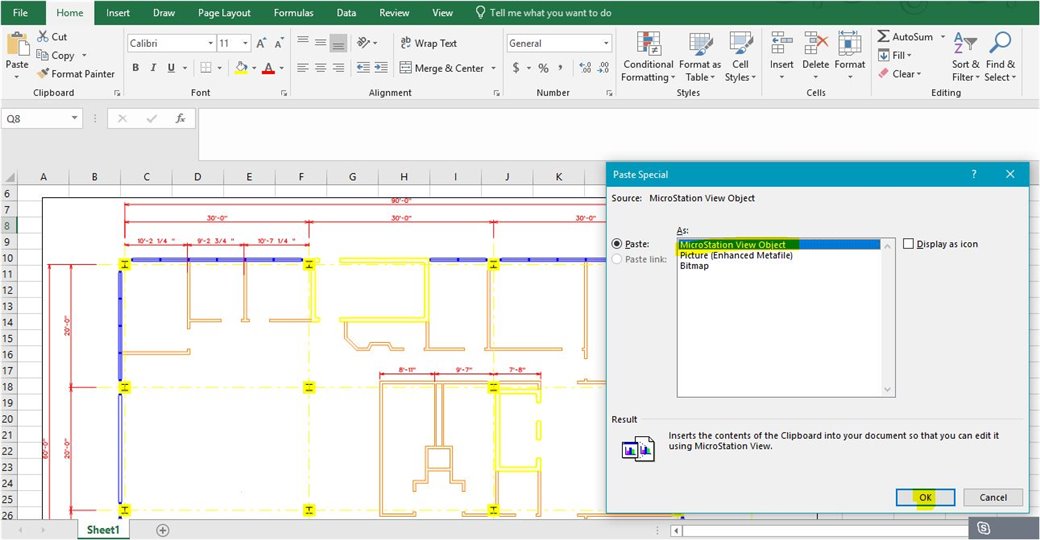

3) Next, open Microsoft Excel program , right click and Paste special, > Paste >MicroStation View Object
