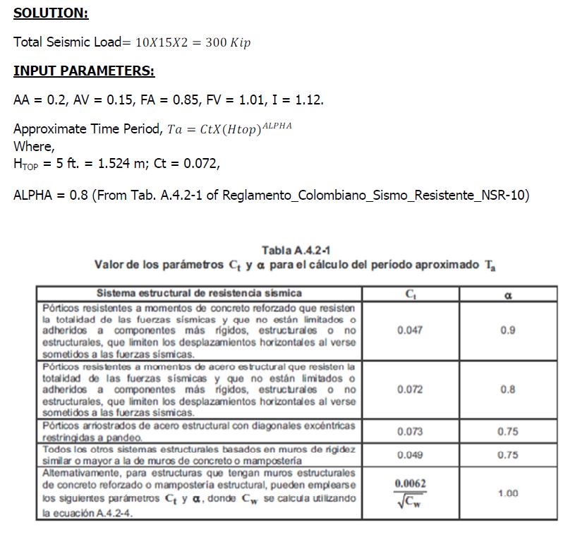

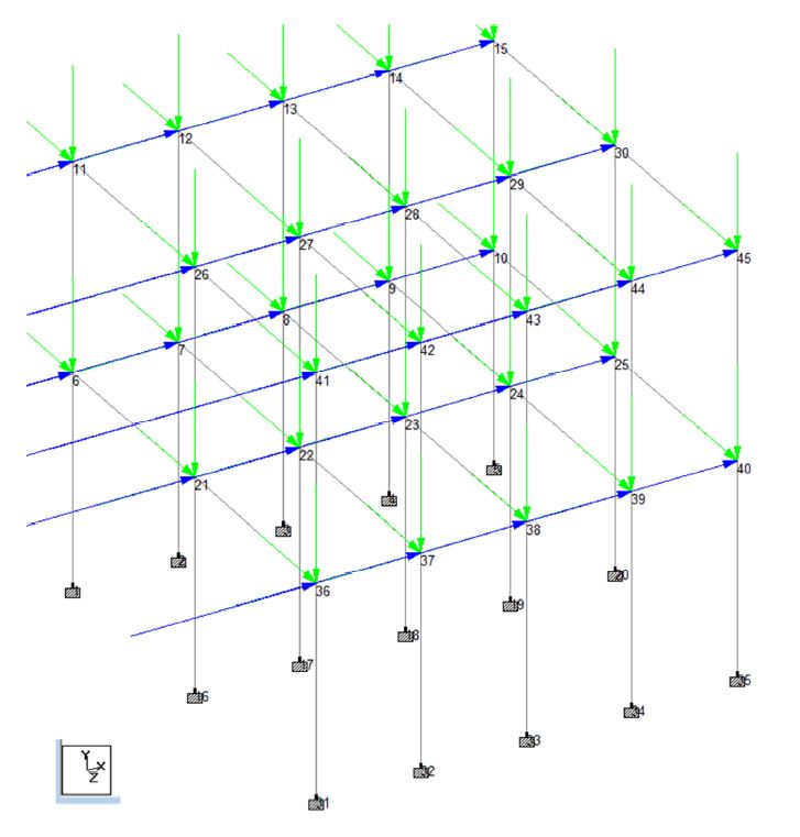

There are 15 nodes on each floor level. Each node has been given a seismic load of 10 kip along positive Global Y direction. Load Factor is 1.2.
| Applies To | |||
| Version(s): | All | ||
| Environment: | N/A | ||
| Area: | Analysis Solutions | ||
| Subarea: |
Response Spectrum Analysis | ||
| Original Author: | Sujoy Roy Bentley Technical Support Group | ||

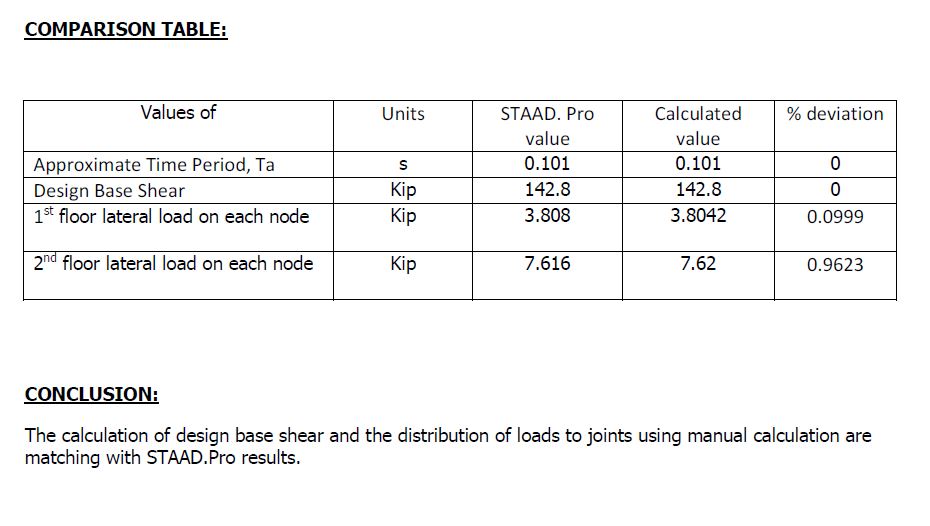

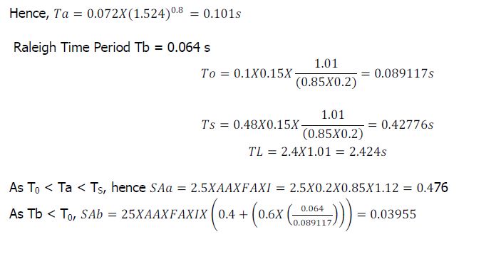

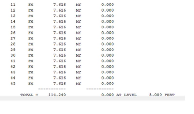

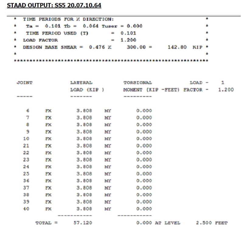

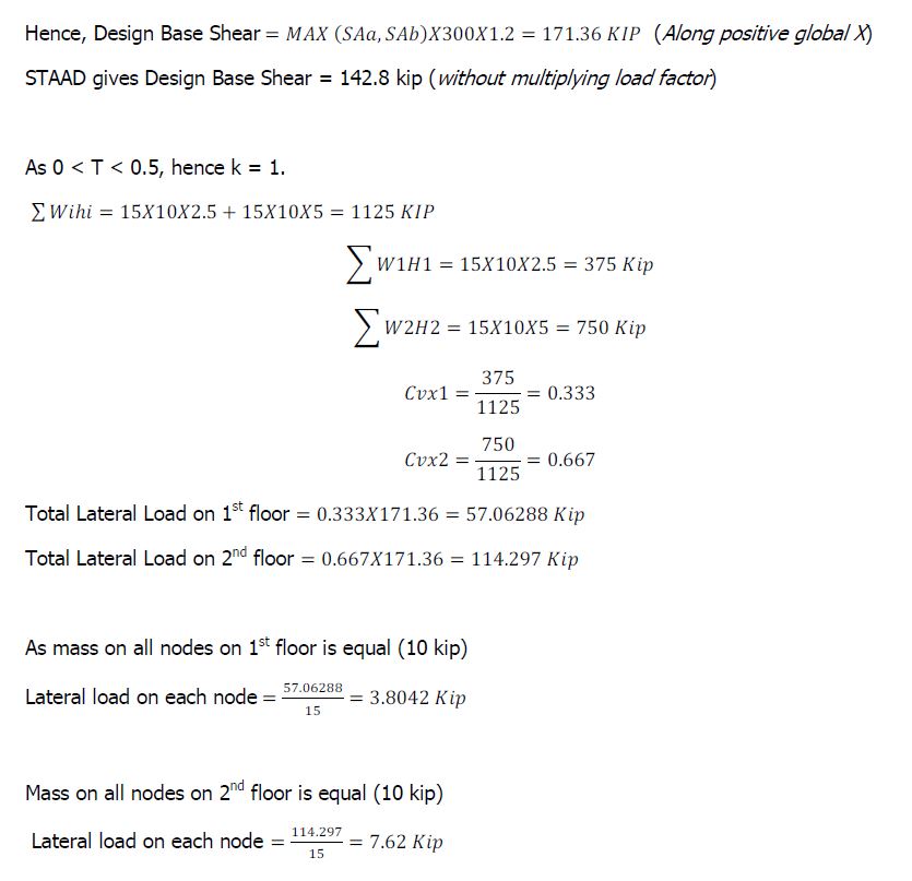

Calculation of the design base shear from Rayleigh time period and to verify proper distribution of load to all the different joints in the structure. The structure modeled in STAAD. Pro is shown below:
