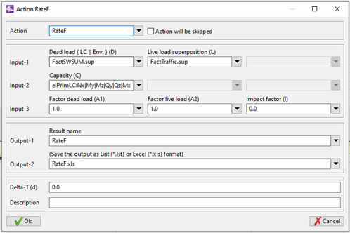

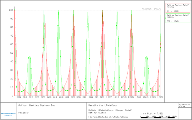

RM > Analyzer > RateF schedule action evaluates the load rating factor for the bridge structure according to AASHTO code.
Parameters necessary to be introduced are:
Dead load: FactSWSUM.sup
Live Load Sup: FactTraffic.sup
Capacity: Steel PrimLC
Output : RateF
