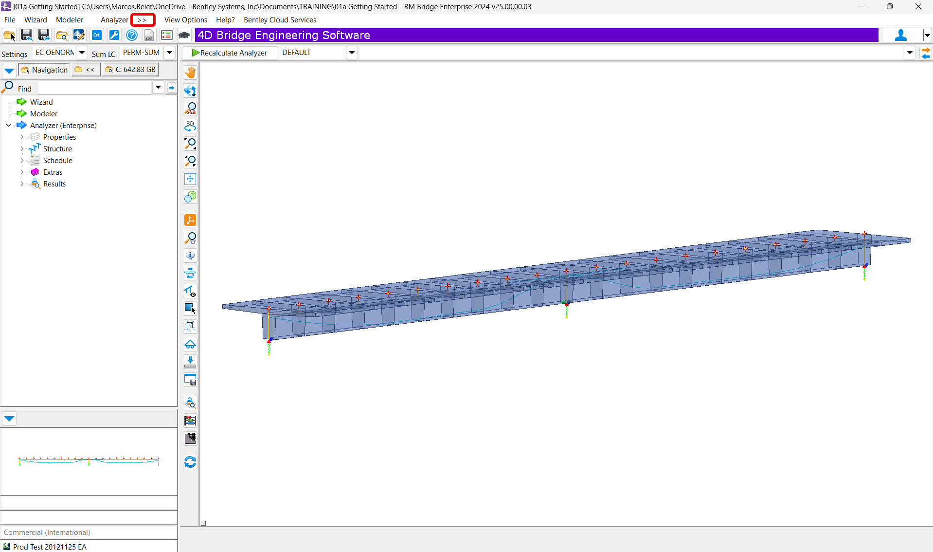

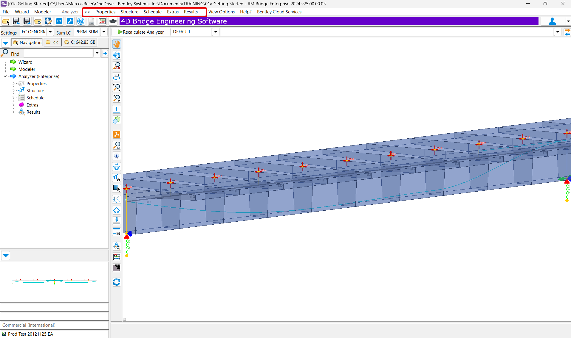

The RM Bridge Main Menu is a Ribbon main menu bar at the top edge of the Graphical User Interface. The start screen consists of 7 options that can be expanded using the 5th button ">>" for full visualization of all 13 options, as shown in the two images below.
- File: project administration and file operations functions
- Wizard: different pre-processors
- Modeler: internal geometric preprocessor (formerly called GP from Graphic Preprocessor) for a more graphical definition of the basic element definitions like axes, segments, cross-sections etc.
- Analyzer: functions for computational mathematical model analysis, including:
- >> / << expand or contract the top Main Menu Analyzer options, as shown in the two screenshot images below
- Properties: physical and administrative properties of the structure
- Structure: basic structural parameters
- Schedule: construction sequence
- Extras: special additional functions
- Results: functions for presenting analysis results on the screen and creating result graphics
- View Options: functions for governing the graphic presentation of the model on the graphic screen
- Help?: technical support links and documents.
- Bentley Cloud Services: functions to manage CONNECT Projects and open CONNECT portals
