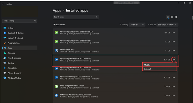

- For existing installations: If the software has been installed already, the above menu can be accessed by going to Control Panel > Programs and Features > Apps > Installed Apps. Right click on OpenBridge Designer or Modeler or at the three dots button and select Modify:

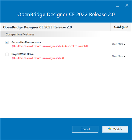

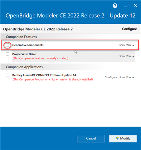

- After the modify dialog comes up, you need to tick the box for OpenBridge Generative Components
- Select Modify and proceed with the installation.
- Once Generative Components is installed, you can access the Computational Design Workflow when searching thru the workflows.
