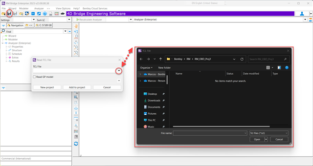

To import the RM Bridge .tcl data file the user should use the command Read TCL file, as shown below.

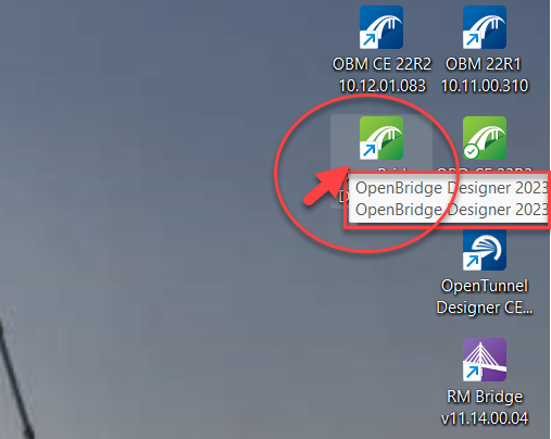

From inside OpenBridge Designer, this needs some additional steps, described below.
First, the user needs to select Start OBD, not OBM.

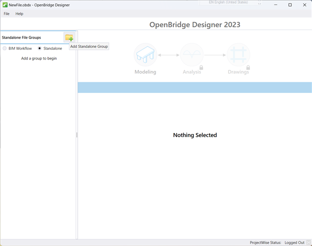

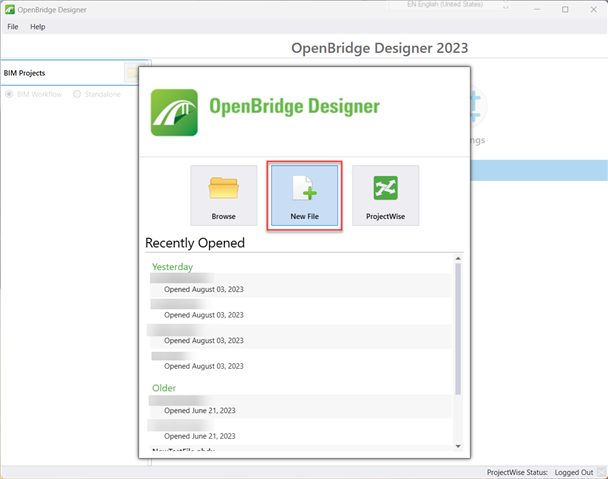

Secondly, a New File should be created, as shown below.
Usually, a Standalone Group is created to receive the model information.

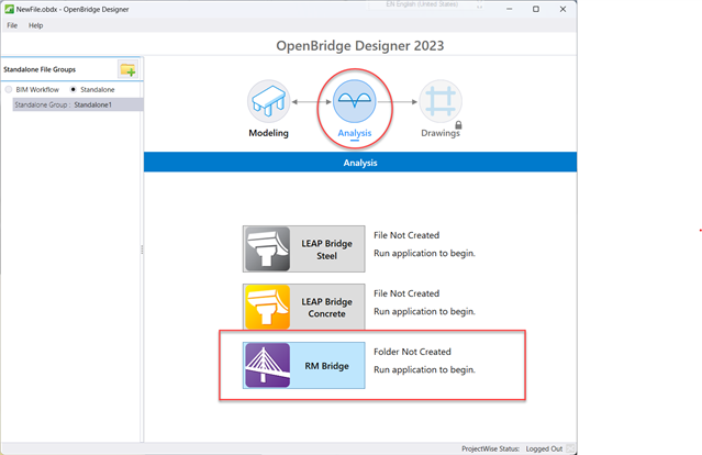

Then, Analysis is selected as well as RM Bridge, as highlighted below.

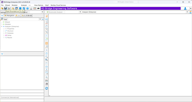

Inside RM Bridge, the Read the project as TCL file is selected.
