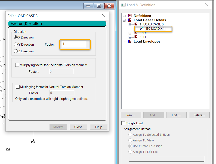

Base shears, reactions, moments all reported as zeros for generated seismic load case
Product(s):STAAD.Pro
Version(s):ALL
Environment: ALL
Area: STAAD.Pro Analysis Solutions
Subarea: Seismic Load Generation
Original Author:Sye Chakraborty, Bentley Technical Support Group
I have generated my seismic load using the equivalent static method. However I am getting zero base shears or reactions/forces for that load case. What am I doing incorrectly ?
The direction factor may have been specified as zero for that load case. Please go to the Load & Definitions window and double click on the seismic load item as marked below and make sure that you have a non-zero value specified for Factor
