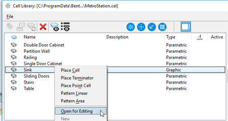

Having created a Cell Library containing working Parametric model(s) with Variations, when placing these Models as Cells into a Design the Variations cannot be selected at time of placement.

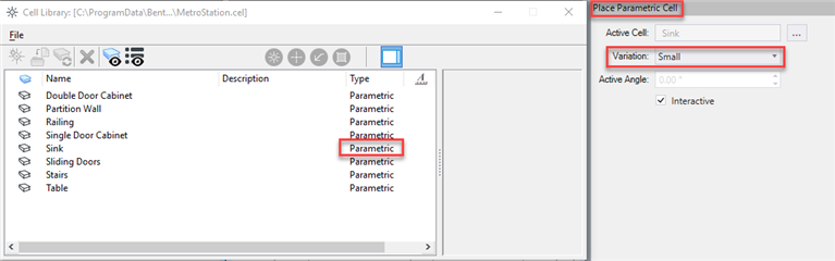

In order for the Models Parametric Variations to be available when being placed as a cell it has to be placed as a Parametric Cell.

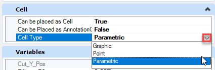

To make the Cell a Parametric Cell:

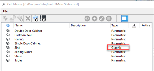

            (Note in the Cell Library Dialog against the Name of the cell its Type if 'Graphic' or 'Point' then the Cell will need to be edited)
