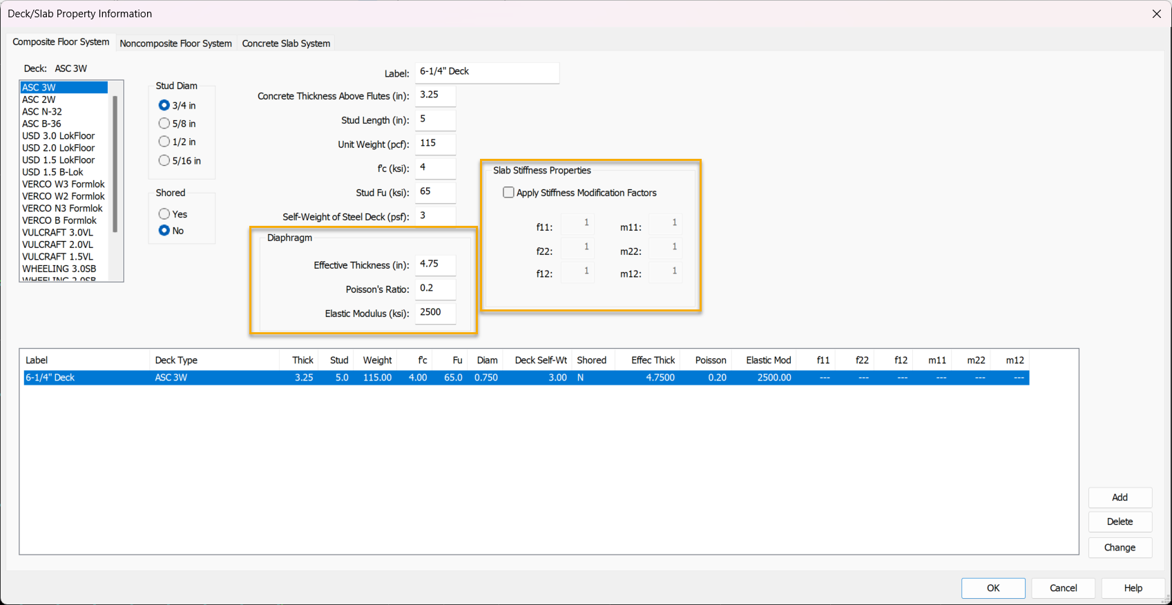

Semirigid diaphragms are meshed into quadrilateral plates within RAM Frame or Ram Concrete Analysis using the properties of the deck defined in RAM Modeler. For composite and non-composite decks, the Effective Thickness, Poisson’s Ratio, and Elastic Modulus in the Diaphragm box are used for the plate properties. Optional Slab Stiffness Modification Factors can also be applied. Stiffness modifiers cannot be zero but small values (e.g. 0.01) and values greater than 1 are accepted.

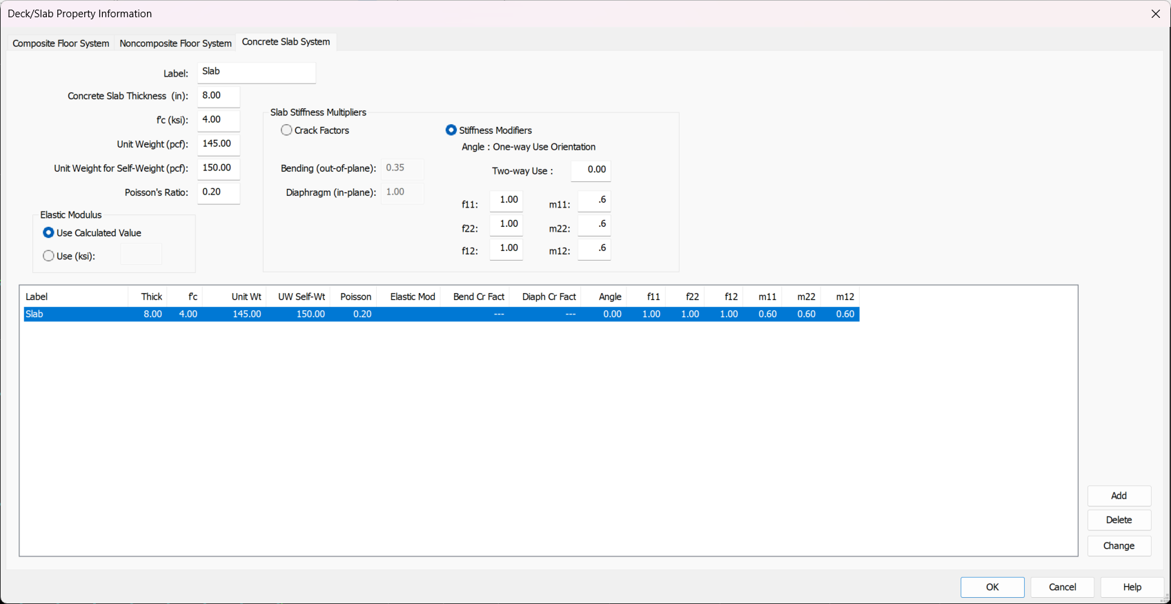

For concrete slabs, the Concrete Slab Thickness, Poisson’s Ratio, and Elastic Modulus are used for the shell properties. In addition, the Cracked Factor – Bending can be used to modify the out-of-plane stiffness and the Cracked Factor – Diaphragm can be used to modify the in-plane stiffness. Stiffness Modifiers are also available for concrete decks.
In some older versions of the software the Cracked Factor - Bending was applied to the deck thickness, affecting the deck out-of-plane inertia cubically. That was changed in 14.06 so that the cracked factor is now applied to linearly reduce the deck out-of-plane stiffness.

Some engineering judgment is required when determining the properties of composite decks and concrete slabs defined as semirigid diaphragms, because cracking can affect the stiffness. ACI 318-11 Section 10.10.4.1 lists approximate effective moment of inertias that are permitted for various structural members. Although there is not a factor for diaphragms, the factors listed for walls may be most appropriate for use with diaphragms. ACI states that 0.7Ig should be used for uncracked walls and 0.35Ig should be used for cracked walls. You could run a hand calculation on your diaphragm to get an idea of what the stresses might be and compare those stresses to the modulus of rupture. Alternatively, you could envelope the stiffness and run the model twice: once with 0.35Ig and once with 0.7Ig. For a concrete slab, the factor should be entered as the Cracked Factor – Diaphragm defined with the deck properties. For a composite deck, the factor should be incorporated into the effective thickness that is defined with the deck properties. For example, if you have 4 inches of concrete above the flutes and want to use 0.35Ig, the effective thickness would be 0.35 * 4 = 1.4 inches.
For composite slabs, most engineers ignore the stiffness of the metal deck and enter the Elastic Modulus and Poisson’s Ratio for concrete. Some engineers ignore the concrete within the flutes and use the thickness of the concrete above the deck as the effective thickness. Other engineers consider a portion of the concrete and modify the effective thickness accordingly.
