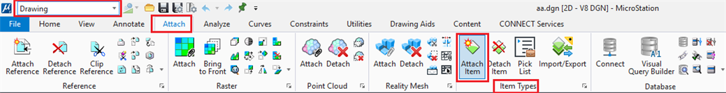

In the Drawing workflow, on the Attach tab, in the Item Types group, select Attach Item.

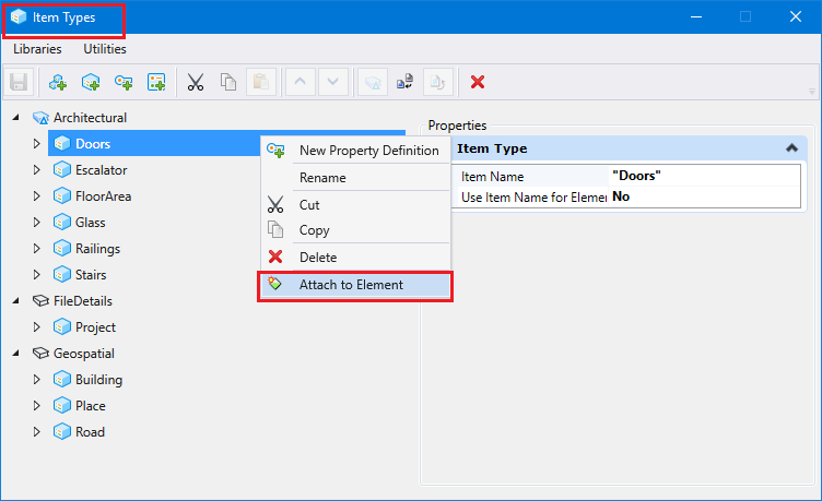

In the Item Types dialog, right-click the item type and select Attach to Element.

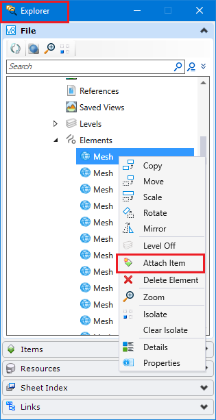

In the Explorer dialog File tab, navigate to an element in the active model, right-click on the element and select Attach Item.
