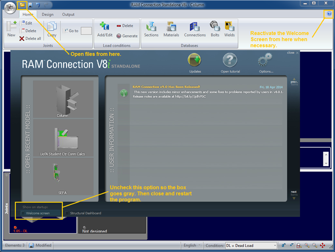

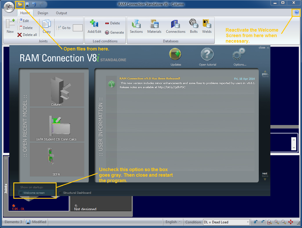

Problem Description
Ram Connection Stand-alone crashes when opening existing files from the file browser or from the Welcome Screen, recent file thumbnails. It may crash right away or only when designing a connection within that file.
This error was resolved for some users with Ram Connection 9.02.00.117. The work-around below can be used with any version.
Work-around: turn off the option to "Show the Welcome Screen on Startup". Then close and restart the program and open the file using the upper left file open button instead.
The Welcome Screen can be reactivated using the link under the Help ?.
