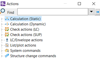

In RM Bridge Analyzer at Schedule \ Stages \ Schedule Actions user defines the time frame for all stage performed calculations. The possible Action input options could be as in the list and as shown in the picture below:
- Static Calculation: available usual static structural analysis;
- Dynamic Calculation: available advanced dynamic structural analysis;
- LC Check actions: schedule actions performing proof checks for individual load cases, either directly calculated or generated;
- Sup Check actions: schedule actions performing proof checks for superposition files;
- LC/Envelope actions: available Load Case and Envelope manipulations;
- List/plot actions: result-list and plot actions;
- Systems commands: available Copy, Show, Delete, Rename, etc...;
- Structure change commands: available Change of Start or End Nodes, Activation or Deactivation, and Cross-section properties modifications of Elements.
