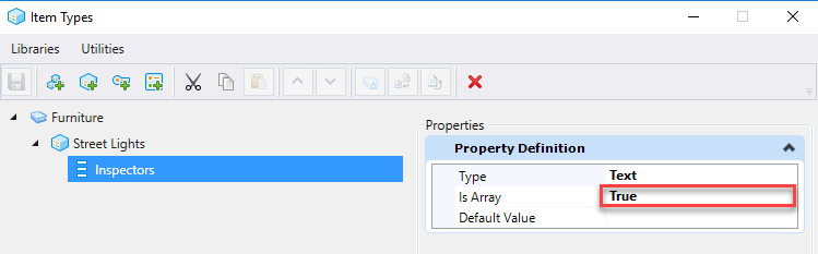

Sometimes Items attached to elements may need to allow for multiple values to be entered into a Property Definition, for example to record multiple team members against the Element the Item is attached.
When defining the Item Property Definition, the 'Is Array' should be set to 'True' to allow for multiple values to be added to the Property Definition of the Item rather than a single value when set to ‘False’
Entering multiple values to the Property Definition when attaching the Item to an Element
Note: The Item Property Definition ‘Is Array’ needs to be ‘True’

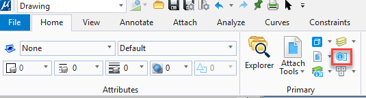

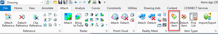

From the Ribbon select the ‘Attach Item’ tool (Drawing > Attach > Item Types)
In the Tool Settings dialog, Select the Item Type to attach
Right Click on Property name ‘Inspectors’ and select ‘Add Entry’
Select the Down arrow and enter the first value required ‘Inspector A ‘
To add more entries Right Click on Property name ‘Inspectors’ and select ‘Add Entry’ again, or Right Click on the First Entry and select ‘Add Entry’ or ‘Add Entry Above’
Note: Use the scroll bars on the right to find the new entry if required
