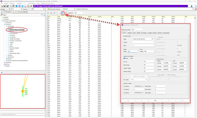

As shown in the screenshot image below, the use of the "information" button icon allows the selected element to be displayed in the complementary window and opens a new Tab with the complete set of corresponding data in the element table.
