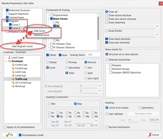

RM Bridge Results Options are definitions for the results to be presented as graphics in the current Windows view. Diagrams are additional definitions for the structure model results presentation that can be scaled and is grouped into a Diagram with its elements results as plotted curves.
As shown in the screenshot below, the plots can be added and removed by right-clicking on the Diagram or at the Curve list. A new diagram curve can be added by using the context menu (right-click) of the menu option "Diagram" or of an existing diagram curve item of this menu option, as well as by clicking the button "Add diagram curve". An existing diagram can be copied, renamed, or removed by using the context menu (right-click) of it. For each Curve, the additional information should be selected:
