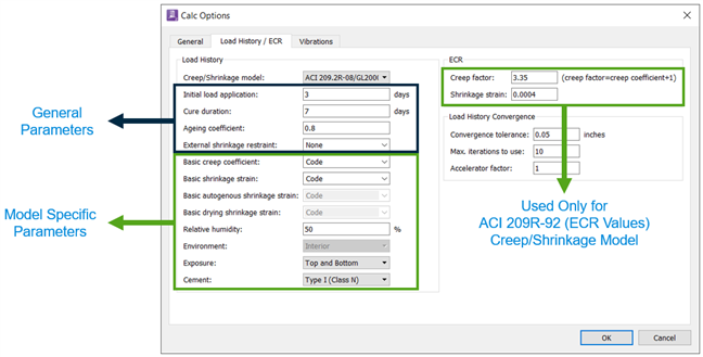

New Creep and Shrinkage Models for Load History Deflections
The ACI 209.2R-08/GL 2000, AS 3600-2018, and Eurocode 2-2004 creep and shrinkage models are now implemented for use in the load history deflection calculations. The ACI 209R-92 model remains and will be the selected code when models created in earlier versions are opened in this or future versions.
The options in Load History / ECR tab of the Calc Options dialog have been reorganized, as shown in the image below, to accommodate the new creep/shrinkage models. The General Parameters marked in the image apply to all creep/shrinkage models. The Model Specific Parameters are used to automatically calculate basic creep and shrinkage coefficients and adjustment factors that are defined in the selected creep/shrinkage model. Code Specific parameters that do not apply to the selected creep/shrinkage model are automatically disabled when that model is selected for use. The creep factor and shrinkage strain defined in the ECR box and marked in the image are used for the ACI 209R-92 model only.

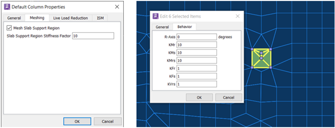

Meshed Rigid Support Regions
An option to mesh a rigid support region is now available in the column and wall property dialogs. When utilized, the rigid support region option forces the program to mesh elements within the plan area of the column elements and walls. The flexural and torsional stiffness of these elements is then modified using the specified “Slab Support Region Stiffness Factor” in the same dialog. The default stiffness factor is 10, which represents the maximum factor permitted by RAM Concept and attempts to create a rigid zone over the supports. This feature may help predict more accurate floor deflections, especially for floors with large columns.

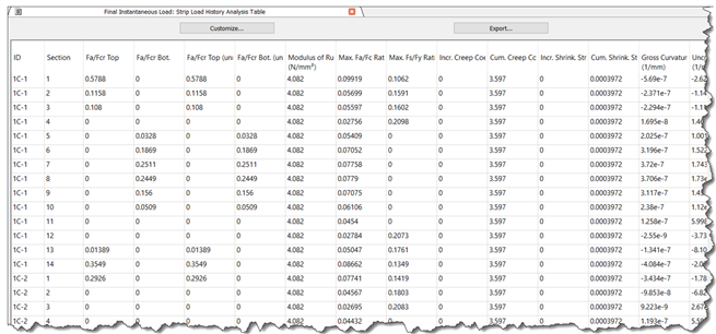

Table for Load History Deflection Analysis Results
A table for load history analysis results is now available on the Load History Deflections Layer. The tables include results and parameters that are directly used by the program to calculate the load history deflections and parameters that are not directly used but are useful for understanding the relative importance of different behaviors, like internal and external shrinkage restraint. A separate table is available for each load history step. Each table includes information for all sections defined in the model. More information on this feature can be found here.

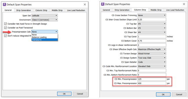

Precompression Checks for Post-Tensioned Sections
A maximum and minimum precompression check for post-tensioned sections has been added to the User Minimum Rule Set. The minimum and maximum precompression limits are defined by the user and are a property of the span segment or design section.
The average precompression in the section can be calculated using the Balance Loading, which includes the effects of diversion of prestress (e.g. into rigid supports) or FpsAse/Ac, which uses the vector component of the effective tendon force perpendicular to the cross section and excludes restraint. When the average precompression stress in the section is less than the defined minimum value or greater than the defined maximum value, a design criteria failure is reported.
These checks are also included in the PT Optimization feature. When the precompression calculations are activated, the user can save time preparing models for optimization by using a wide max/min range (for example, min number of strands = 0, max number of strands = 100) and use the Optimizer to find a solution with the specified precompression range.

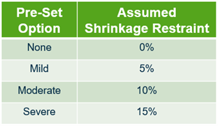

Load History Shrinkage Restraint %
In the Load History Calc Options dialog, the user now has the option of entering a specific percentage for external shrinkage restraint or selecting one of the pre-set options. The pre-set options are mapped to assumed percentages as tabulated below.
In prior versions, a default shrinkage restraint percentage that was used in new RAM Concept models was 20%. The default has now been changed to None, which results in a shrinkage restraint of 0%. This percentage may be appropriate for a typical, intermediate floor in a multi-story structure. However, a larger percentage may be more appropriate for other conditions (podium slab, transfer plate, basement slab, etc.).

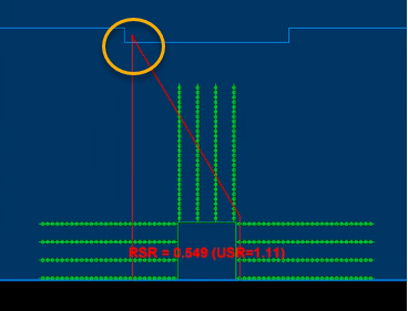

Punching Shear Sections - Exclude Acute Angles
In rare cases, the punching shear check in previous versions may have been governed by sections with acute angles like the one shown in the image below. A change was made to limit the angle between adjacent edges of the punching shear section to 45 degrees. This change will eliminate unrealistic sections from consideration, which will typically improve the reinforcement design of affected punching shear checks.
