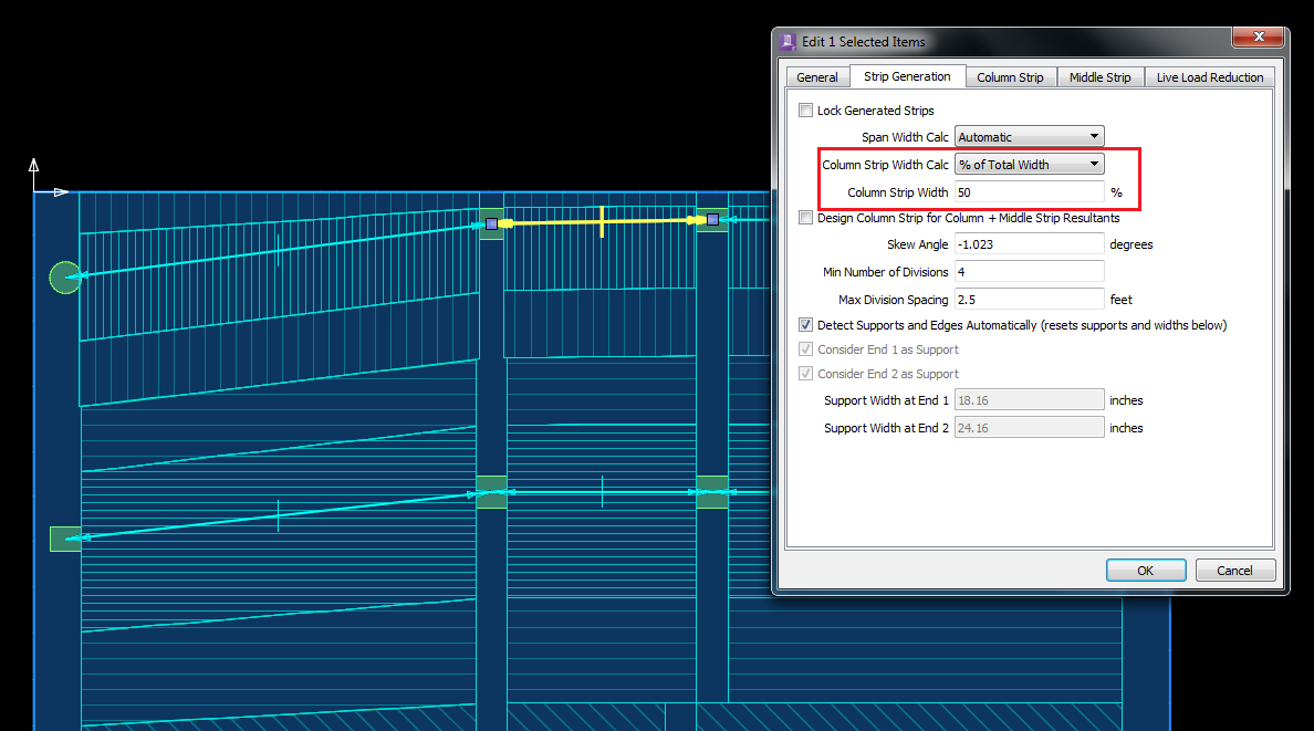

Calculate Column Strip Width as Percentage of Total Strip Width
There is now a new parameter associated with Span Segment objects. This parameter is set on the Strip Generation tab of the Span Segment object properties dialog and is used for the basis of the column strip width when generating strips. The column strip width may now be specified as a percentage of the total strip width. This new option is listed as % of Total Width along side the existing options Full Width, Code Slab, Code T-Beam, and Manual.
