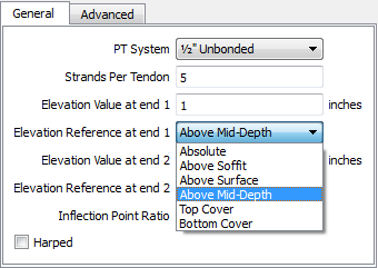

Referencing of Tendons and Reinforcing to Slab Mid-Depth
The vertical elevations of tendon and reinforcing objects (including manual tendons, profile polylines, and reinforcing) can now be referenced to the mid-depth of the slab.

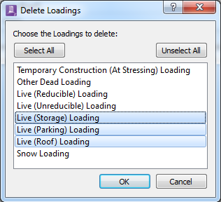

Delete Multiple Criteria Items at Once
It is now possible to select and delete multiple criteria items at once as opposed to deleting items one at a time. This includes entities under the Criteria menu such as materials, loadings, load combos, design rules, etc.

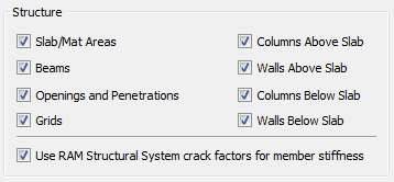

Ability to Import or Ignore Crack Factors from RAM Structural System
When importing a floor from RAM Structural System, the user now has two choices in setting the element stiffness factors in RAM Concept. The crack factors set in RAM Modeler can be imported into RAM Concept and used for all elements, or the RAM Modeler crack factors can be ignored, allowing all of the stiffness factors in RAM Concept to default to 1.0.

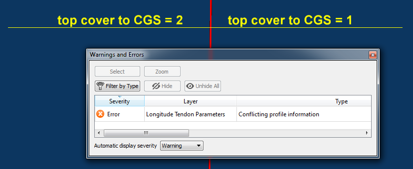

Overlapping Profile Polylines with Differing Properties
A warning is now delivered when two or more profile polylines with differing properties intersect at a tendon location.
