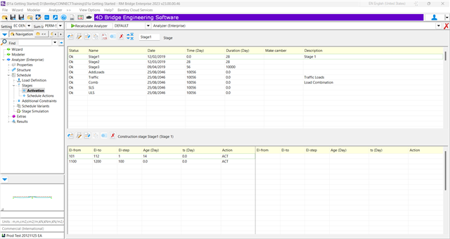

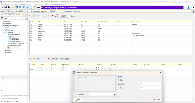

Stages Activation
At RM Bridge \ Stages \ Activation all elements are activated or deactivated for each specified stage. The Top table lists the Stages and the Bottom table lists the element to be (de)activated for the selected top list item. The changes in the element's activation status are either ACT as active or DACT as deactivated.
