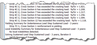

Cracking, Yielding, and Instability Information in the Load History Calc Log
The Load History Calc Log now identifies cross sections that have cracked, yielded, or have local instabilities.
