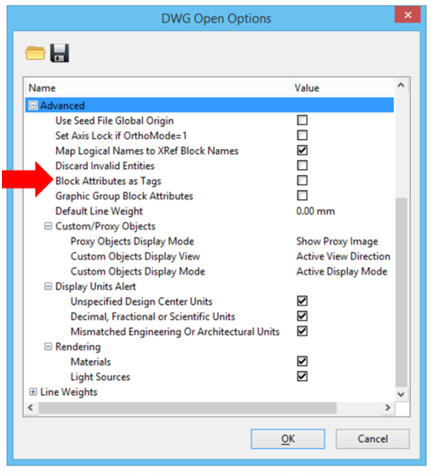

Block Attributes as Tags
A special item type library "DWG Attribute Definitions" is created and used exclusively for DWG attribute definitions. Additionally, you will observe the following behavior when the setting is off:
If an attribute is of MTEXT type their value will be shown in the Properties dialog, however changes to these properties will not be reflected in the text nodes, neither will they be saved back to DWG. If there are no changes made, the text nodes will be round-tripped back to DWG as multi-line attributes.
When a text field linked to a valid item type property is edited, for example, by adding an additional line of text after the field, and when you save the file as DWG, the whole text node will be saved as an mtext entity, and not an attribute entity.
In case you wonder why the difference – this is because a multiline attribute is no longer a field therefore there is nothing to break.  A single line attribute is a field, therefore adding a non-field text breaks it up.
