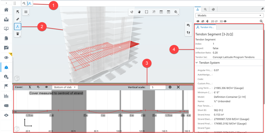

Early Access Program - iTwin Synchronization to Cloud Workflow
The Early Access Program (EAP) for the iTwin Synchronize to Cloud Workflow continues with this version. A practical application of this technology is the ability for RAM Concept users push PT tendon profiles to a 3D analytical iTwin and review those profiles in elevation/cross section views across the floor as shown in the image below.
Figure 1 - Tendon Visualization Mode in iTwin Synchronize to Cloud Workflow
The tags in the image highlight tools and features available in this workflow:
  1. Tendon Visualization Mode – activates the Tendon Visualization mode when working in iTwin Analytical Design Review.
  2. Tendon Selection Tool – selects a tendon profile in the 3D View.
  3. Tendon Elevation View – displays the profile of the selected tendon in a floor cross section view. Use this view to review tendon cover dimensions at any point along the tendon profile.
  4. Tendon Property Pane – displays the properties of the tendon selected in the 3D View.
RAM Concept users can participate in the EAP and access the capabilities available in this workflow at no additional charge. More information on registering in the EAP can be found here.

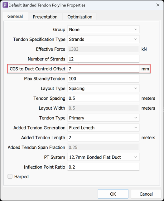

Tendon Property for Duct Centroid Location
PT tendon object properties now include a parameter that defines the vertical offset between the strand and duct centroids. RAM Concept users can utilize this property to determine chair height elevations for bonded PT systems and verify duct cover requirements using iTwin workflows.
This property is available for all tendon objects, including banded tendon polylines, distributed tendon quadrilaterals, and manual tendons.
The offset property does not currently affect the design of PT concrete sections or the visualization of tendon profiles in RAM Concept.

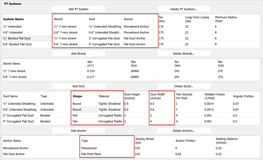

PT System Material Changes
The definition of PT Systems in the Material Specification table (Criteria > Materials) has changed. PT Systems properties are now organized by strands, ducts, and anchors. New properties, which define the geometry of ducts and anchors, have also been added.
New PT System properties include:
None of the added properties currently affect the design of PT concrete sections in RAM Concept. The purpose of the new PT System properties is to represent the tendons better graphically in the iTwin workflows.
Figure 3 - New PT System Material Definitions and Properties

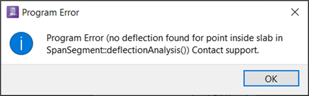

Deflection Checks with Segmented Span Segments and Skewed Sections
When spans were modeled with a series of segmented span segments and the orientations of the cross sections within the segments varied, the deflection check calculations were affected by the following issues:
  1. Deflection limits were evaluated at stations along the span segments that deviated slightly from the design strip cross section locations.
  2. The error below, which prevented the calculations from completing, may have occurred.
Figure 5 - No Deflection Found for Point Inside Slab in Span Segment::deflectionAnalysis()

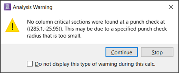

Critical Section Not Found for Punching Shear Checks Due to Skewed Slab Edge
In rare cases, no critical sections were found for punching shear checks near skewed slab edges. For affected punching shear checks, the warning below was generated during the analysis and no punching shear calculations were competed.
Figure 6 - No Column Critical Sections were Found at Punch Check

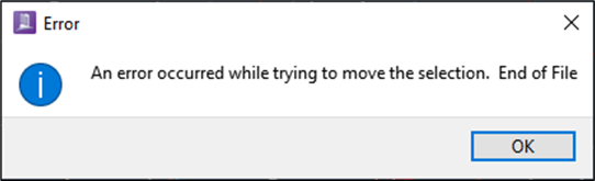

Copy/Paste Fails Intermittently
On isolated machines, the error below was generated when attempting to copy objects or perform a copy-move operation. In a few cases, no error was displayed but a program crash occurred.
Figure 7 - An Error Occurred While Trying to Move the Selection. End of File
