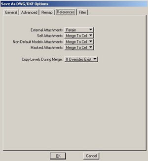

The DWG file format does not support all of the reference types available in MicroStation. As a result, you must use the Save As DWG/DXF Options dialog box>References tab to define how the following types of references are merged into the model:
Figure 1: The Save As DWG/DXF Options dialog box, References tab

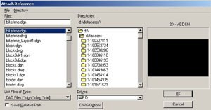

In the Primary toolbox, click the References icon. The Reference dialog box opens.
In the dialog box's tool bar, select the Attach Reference tool. The Attach Reference dialog box opens.
Select the DGN file that contains the model to attach as a reference, and click OK.

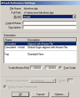

The Attach References Settings dialog box opens.
From the Nested Attachments options menu, choose Live Nesting.
The Nested Attachments options are only available when the selected model has reference attachments. When the Live Nesting option is on, the hierarchical structure of any nested references are maintained when attaching the parent reference to a model.
In MicroStation, a nested attachment is displayed only if the child reference does not have its Ignore Attachment When Live Nesting setting turned on (in the Attachment Settings dialog box), and the parent reference has Live Nesting enabled. This is an important fact and is sometimes overlooked by users.
In the Nest Depth field, enter a high value (for example, 10).
Set the depth setting to a high number to include even the most deeply nested references when the file is saved to DWG. Although the nested attachments will display in the view window, you will see only the parent reference in the References dialog box's list box. This setting can be selected when attaching the reference file.

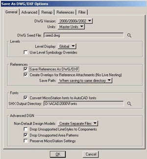

Figure 5: Save As DWG/DXF Options dialog box, General tab
When you save a DGN file to a DWG file, you can save reference attachments to DWG files as overlays. To do this, open the Save As DWG/DXF Options dialog box and turn on Create Overlays for Reference Attachments (No Live Nesting). When this setting is on, all references are created as overlays, whether or not the Ignore Attachment When Live Nesting setting is on. This setting effectively disables live nesting in the DWG output file. It is useful for files where live nesting is turned off for all attachments.
