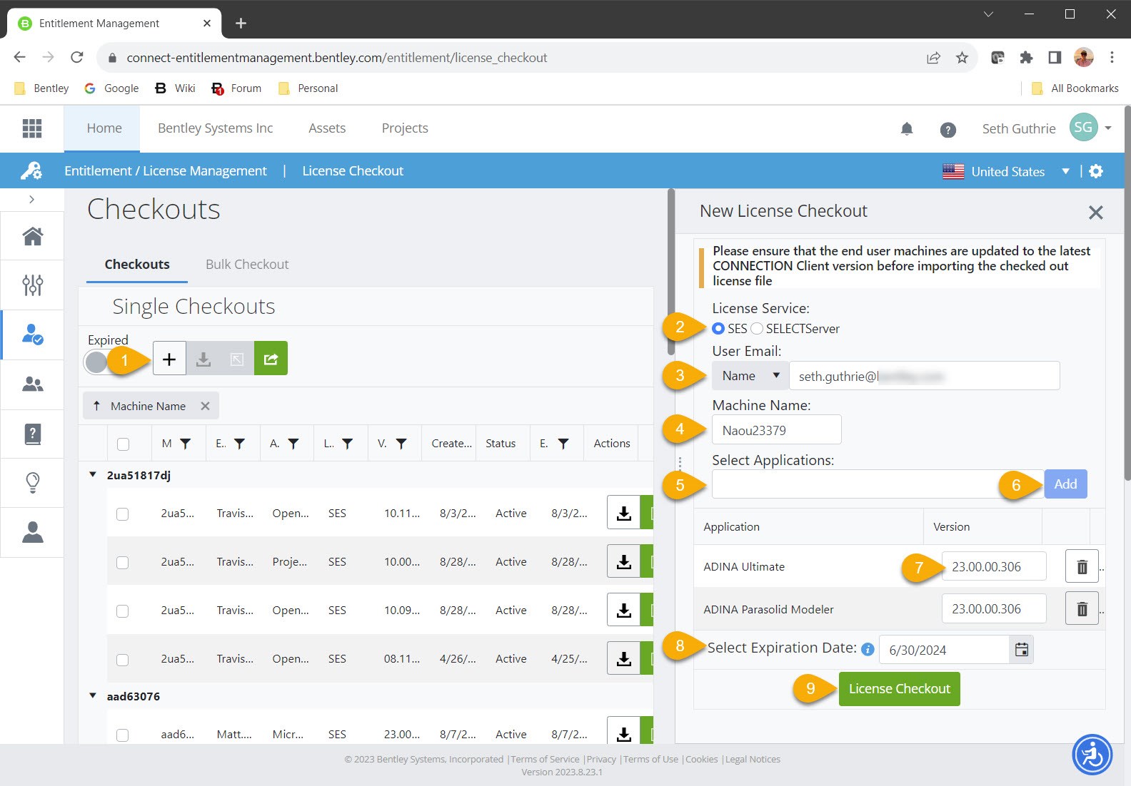

With ADINA, it is important to check out the correct tier; ADINA, ADINA Advacned or ADINA Ultimate and select that same tier when opening the application. If the ADINA Parasolid Modeler is to be used, then it should also be checked out. This can be done with a single checkout by Adding ADINA Parasolid Modeler before clicking [License Checkout].
Once you get to the License Checkout screen https://connect-entitlementmanagement.bentley.com/entitlement/license_checkout follow these steps:
  1. Click the "+" to start a New Checkout
  2. Select SES
  3. Select the user name (the user must be a registered CONNECTED user in your organization)
  4. Identify the machine name where the license will be used
  5. Select the Application; ADINA, ADINA Advanced or ADINA Ultimate
  6. Click Add. If another application like ADINA Parasolid Modeler is needed, add it also.
  7. Identify the version numbers to be used
  8. Select the expiration date
  9. Click License checkout and save the .belic file
