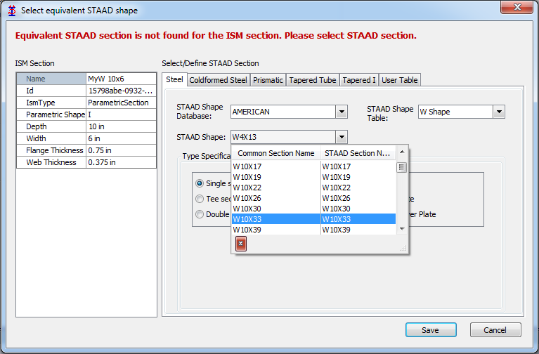

  1. First, STAAD looks into its mapping table to check if its section is associated with ISM.
  2. If not found, STAAD sends the section name to ISM for a lookup.
  3. If not found, then it pops the mapping dialog for the user to map.

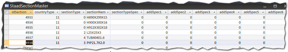

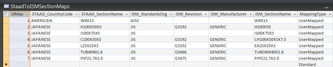

But one thing can be done to avoid the mapping dialog. If you refer Shapes19S3.mdb, Table ‘StaadToISMSectionMaps’, you will see the following entries in the table:
& ‘StaadSectionMaster’:
The default location for the file is:
V8i - C:\SProV8i SS5\STAAD\Plugins\StrucLink\Data\Shapes19S3.mdb
CONNECT edition - C:\ProgramData\Bentley\Engineering\StrucLink\Data
If one can create entries for mappings in the above tables, then this can be avoided. We suggest using the user interface to map sections and avoid potential errors manually entering data into the tables however. (Please do not refer to the ‘Shapes’ table in the database. It is used by ProSteel.)
