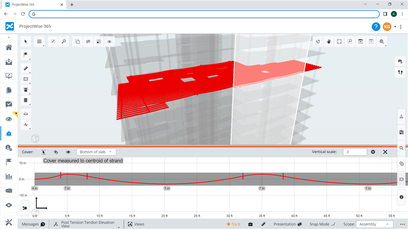

The Early Access Program (EAP) for the iTwin Synchronize to Cloud Workflow continues with this version. A practical application of this technology is the ability for RAM Concept users push PT tendon profiles to a 3D analytical iTwin and review those profiles in elevation/cross section views across the floor (see image below). RAM Concept users can access the capabilities of this workflow at no additional charge by participating in the program. After the EAP concludes, a separate license will be required to access the cloud synchronization features. The local iTwin Synchronize to File Workflow is and will continue to be included with the RAM Concept license. More information on participating in the EAP can be found here.

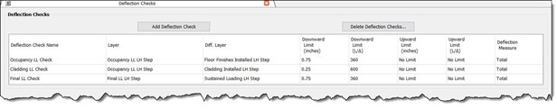

Deflection Checks

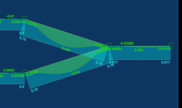

Maximum and minimum deflection limits can now be defined and checked during the design calculations. The deflection limits can be based on absolute deflection or span deflection (L/D) and are compared to calculated deflections, which can be total deflections or differential deflections between any loading, load combination, or load history step.
Deflection limits can be assigned to span segments or to new deflection check line objects, which can be modeled at any location on the floor.
The results and design status of each deflection check are summarized on a new Deflection Check Layer.

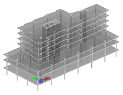

Individual RAM Concept models can now be synchronized into a single local or digital iTwin repository. This allows users to create full 3D iTwin repositories from floors modeled in separate RAM Concept files.
A tutorial for this workflow, including sample files, is also available. See “Other Changes” section below for details.

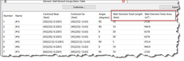

Wall length and area are now tabulated for each wall element group. These properties can also be extracted using the scripting API. Wall reactions per unit wall length can be calculated by associating Wall Group Names with Wall Group Reactions and the new Wall Element Total Length property.

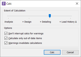

In the Calc Partial dialog, the Extent of Calculation options have been changed and now include an option to include the Load History Deflection calculations in the analysis. The “+ Load History D” will be useful when using deflection checks that reference load history layers.
This option will also allow for load history deflection calculations to be run to completion without interrupting errors or warning messages. This can be done by using the “Don’t interrupt calcs for warnings” option when the “+ Load History D” option is selected.
