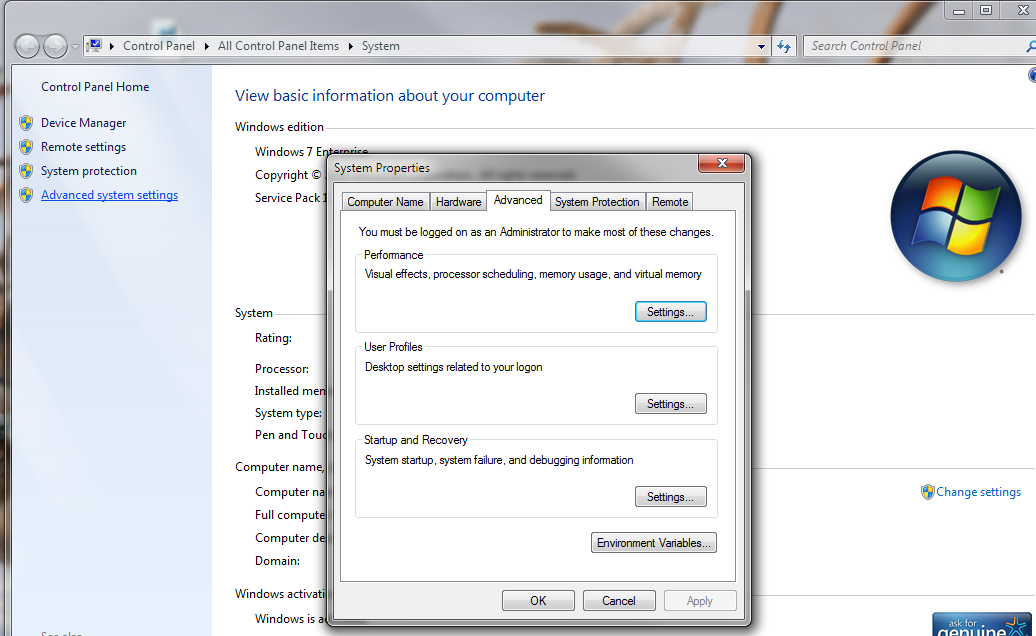

1. Right Click on "Computer" and select "Properties"
2. Click on "Advanced System Settings"
3. In "System Properties" open the "Advanced" tab and then click on "Environment variables"

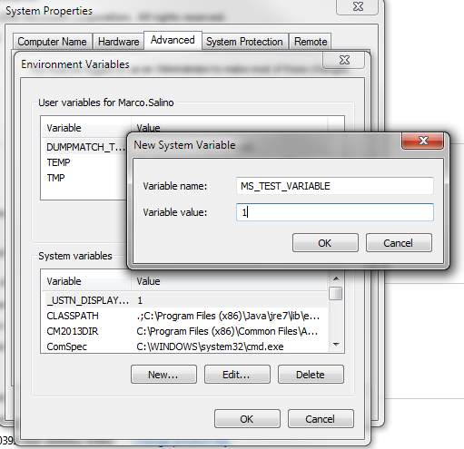

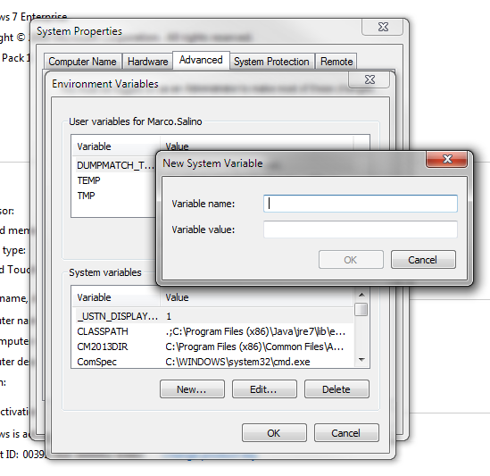

4. in the "System Variables" section of the "Environment Variables" dialog, click on "New"
5. In the "New Variable" dialog enter the Variable name and value.
6. Click "Ok" and close all the dialogs.
