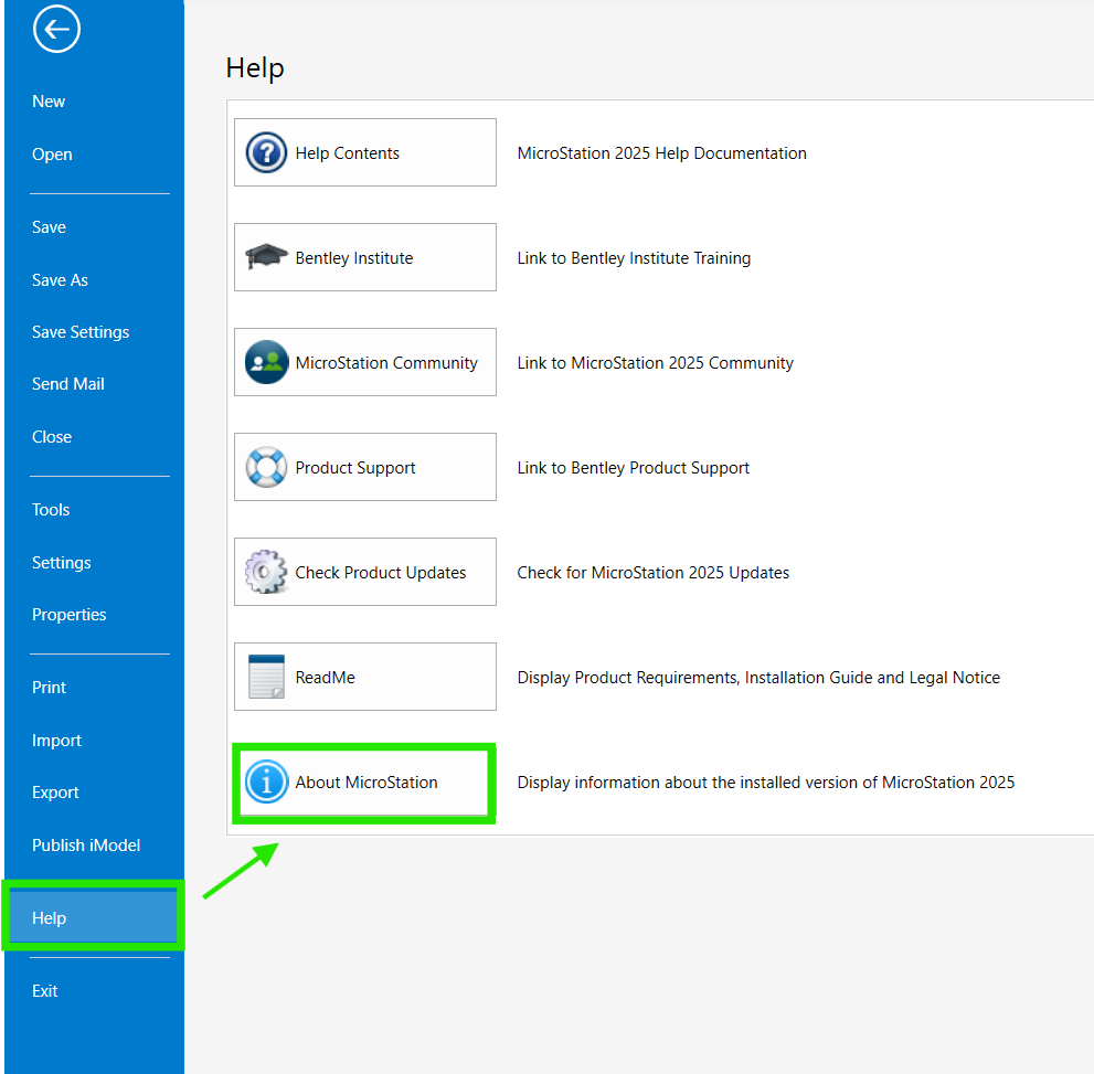

Option 1 - On the ribbon

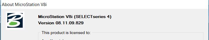

In MicroStation open the Help > About MicroStation dialog
You will find the MicroStation version number (i.e. 25.00.01.62)
Option 2 - File
In MicroStation go to File > Help > About MicroStation

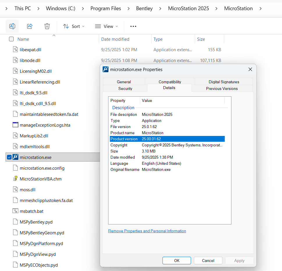

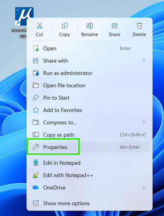

If, for some reason, you are not able to open MicroStation, right click on MicroStation's shortcut, either on your desktop or in the Start-menu and select "Properties":
  1. In the "Properties->Shortcut->Target" field you will find the path to "microstation.exe". Click the button 'Open file location'.
  2. Windows Explorer will open and "microstation.exe" will be highlighted. Right click on "microstation.exe" and select Properties. In the Properties dialog, select the "Details" tab, there you can see the Product Version and release number (i.e. 25.00.01.62).

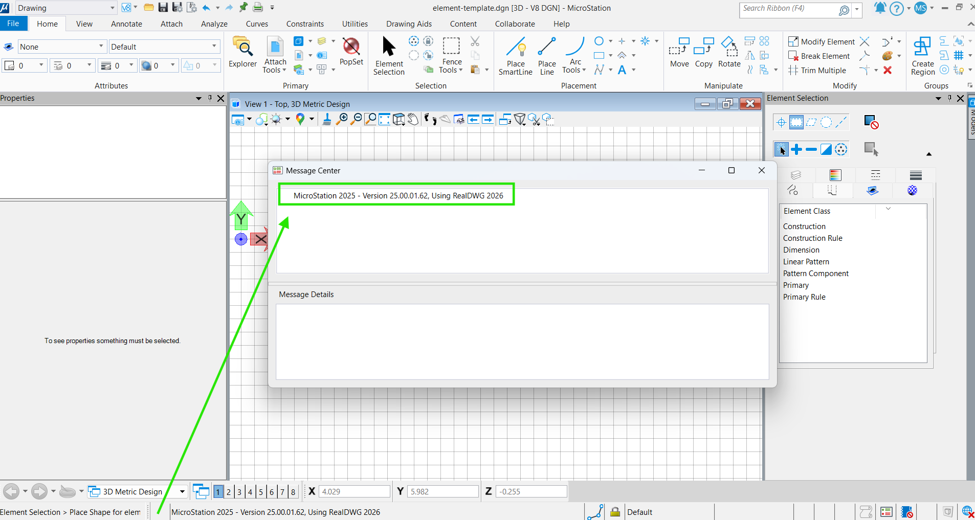

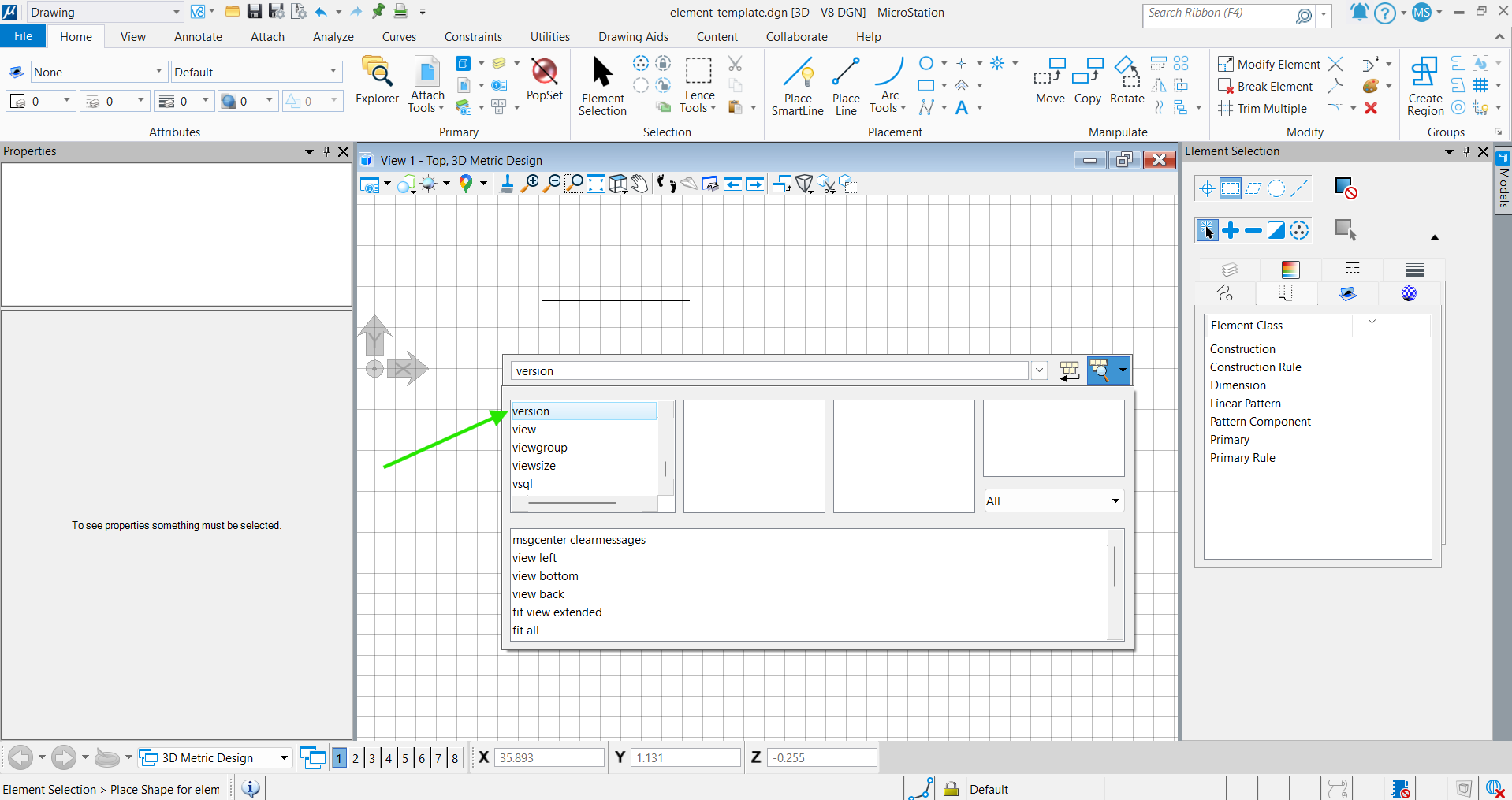

Option 4 - Keyin
Menu: Utilities > Keyin > version
Version number is displayed in Message Center at the bottom
