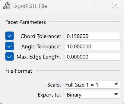

Increase the values for Chord Tolerance, Angle Tolerance and Max Edge Length.
- Go to File > Export > 3D Modeling File Types > Stereolithography (*.stl).
- In Save As Stereolithography File:
- Choose the file name and location.
- Set facet options (Chord Tolerance, Angle Tolerance, Max Edge Length).
- Choose Binary or ASCII STL.
Export STL File Dialog
