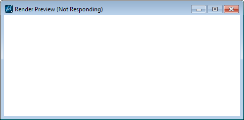

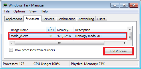

How to stop a rendering process without closing MicroStation
Option 1: Right-click on the Render Preview dialog
Option 2: End the process using Windows Task Manager
