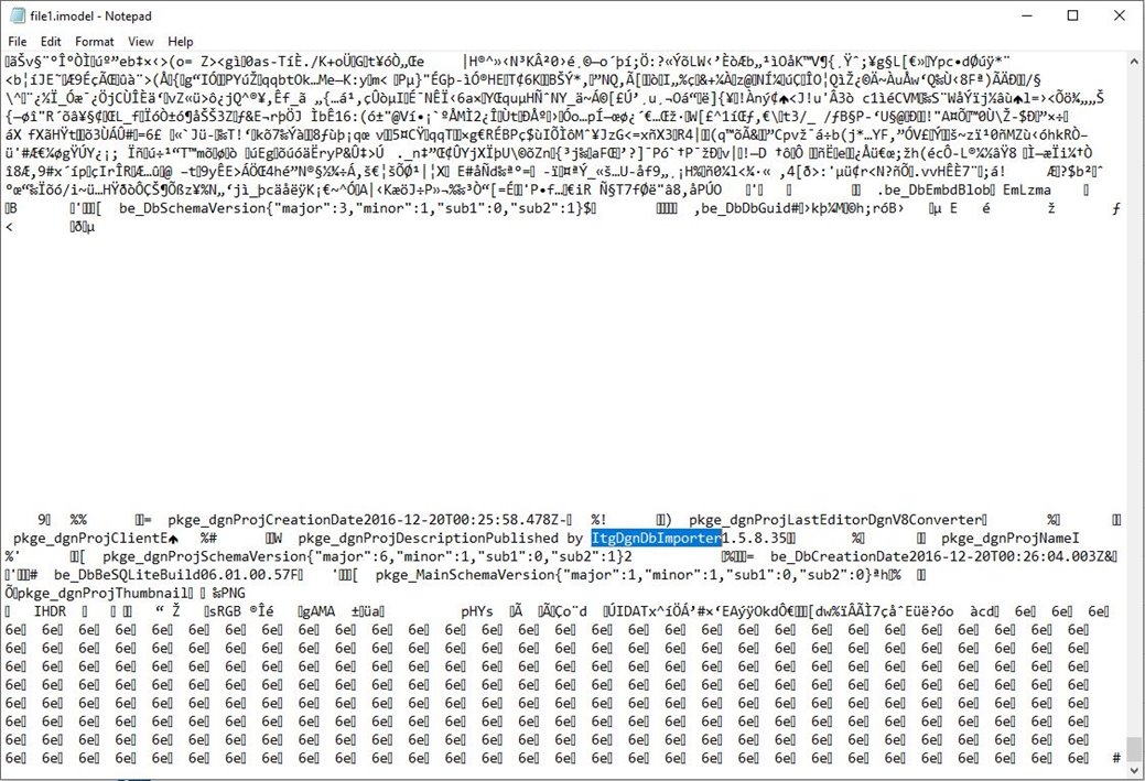

You can find the *.imodel file version by simply following these steps.
  1. Open the *.imodel file using the Notepad text editor supplied with Windows. Near the end of the file you will see text like:
    ItgDgnDbImporter *.*.*.*
    For example: The following screen capture shows the text ItgDgnDbImporter 1.5.8.35
  2. The version listed next to the text ItgDgnDbImporter is directly related to the version of *.imodel file that has been created.
    ItgDgnDbImporter 1.5.7.x or below version produce a 1.5 iModel version
    ItgDgnDbImporter 1.5.8.x, 1.6.x.x and below 2.0.x.x produce a 1.6 iModel version
