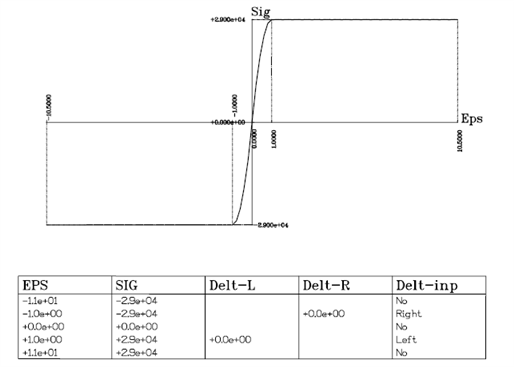

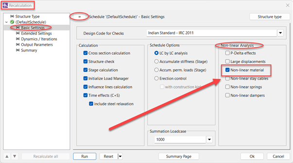

In RM Bridge, inside OpenBridge Designer, the user can select the Non-linear Material option at the Non-linear Analysis options inside the Basic Settings Tab of the Analyzer Recalc Window for the consideration of the non-linearities in the modeled structure. The option Non-linear Material activates the nonlinear material properties by using the stress-strain diagram "Non-lin" and existing reinforcement in any cracked concrete elements. The nonlinear material properties are considered according to the definitions at Analyzer > Properties > Material > Non-linear > Stress-strain diagram.

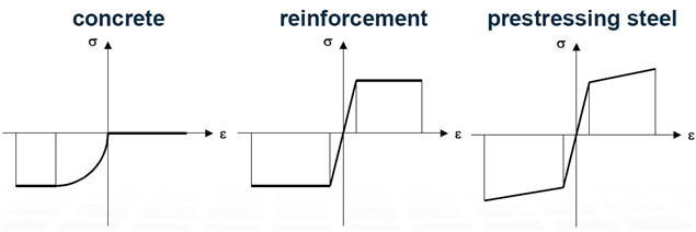

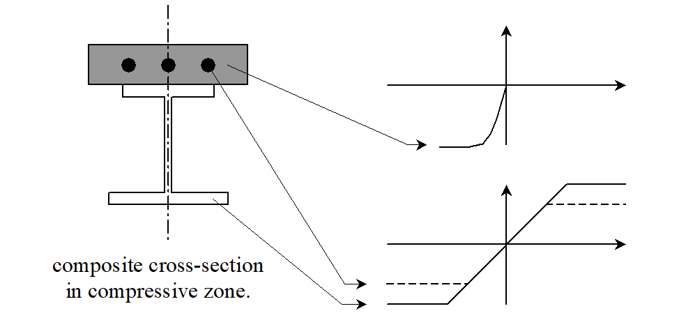

The structural analysis is performed as a 1st iteration that results in node displacements and the respective element forces. Then, these element forces as distributed for the equilibrium on the cross-section level. The software takes into account the non-linear relation between stress and strain according to the arrangement of the different materials in the section database, like a concrete section with reinforcement, and/or pre-stressing steel, a composite section like steel and concrete, or concrete-concrete composite with pre and post-tension.
The finite element model of the cross-section and the material properties in the program database are used for the different materials with their complete non-lin diagrams resulting in different strain, stress redistribution, and the respective iteration internal forces.

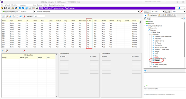

In Analyzer > Structure > Elements > Checks, the consideration of non-linear material properties should be switched on for the required individual elements and it will only be calculated if the Non-linear material has been selected in the Recalculate Window in the Analyzer, as shown in the images below.
Hint: When stresses are displayed in diagrams, they are recalculated from the stored strain plains. In order to display non-linear material stresses correctly, the RMSET definitions have to contain Plot Parameter settings for the non-linear stress-strain diagram.
