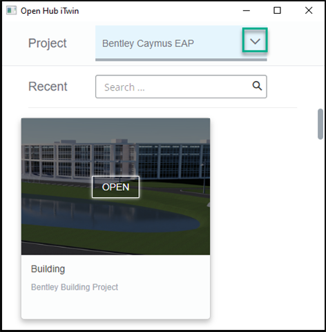

Open Hub iTwin
1. Route to the iTwin server
2. Add credential to open iTwin serve
3. Select any project from the server by drop-down the list.
4. Open iModel by click on the 'Open' Menu.

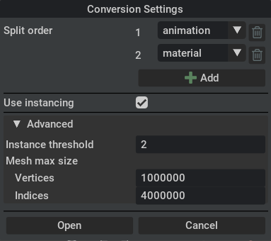

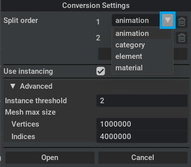

After opening the iModel, LumenRT for NVIDIA Omniverse asks you to convert it by category. Up to 2 levels of model splitting can be done here.
There are 4 types of split order available to split the model.
  • Animation: It is used when importing an iModel with SYNCHRO Animation.
  • Category: Twin categories or CAD levels/layers.
  • Element: Relates to the iTwin object name.
  • Material: iTwin Materials.

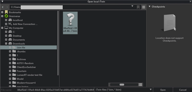

Open Local iTwin
 Open the iModel from the local hub. Browse to the folder where the local iModel is saved and open directly into LumenRT for NVIDIA Omniverse.
