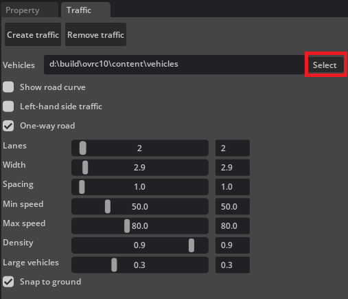

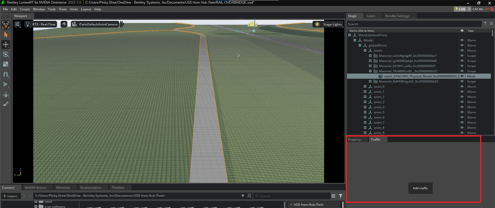

To create traffic into your model click on 'Add traffic'.

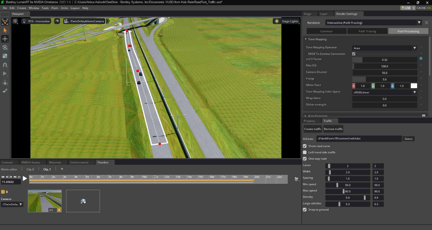

The first step in adding traffic to your model is defining the route. While holding down the SHIFT button, draw the traffic path in the viewport. Release the SHIFT button to insert new or select/move existing key-points. You can also modify tightness of a selected key-point by pressing +/- keys, or remove it by pressing R key.
After creating the path, you need to choose the vehicles from the library. To choose vehicles click on "Select", it will route you to vehicles library.
By clicking on the vehicles it will get selected. Click on "Ok" after selecting the vehicles.

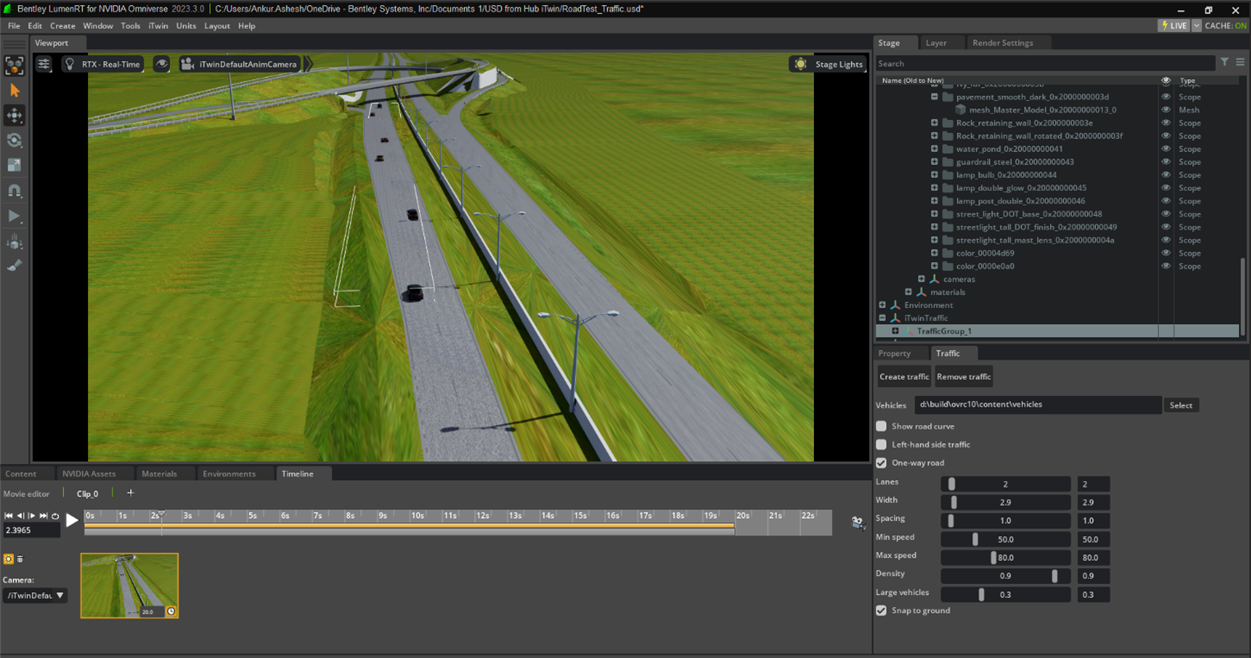

Click on "Create traffic" in order to see the traffic in the path.
Go to Movie editor/ Time-line to see the traffic animation.

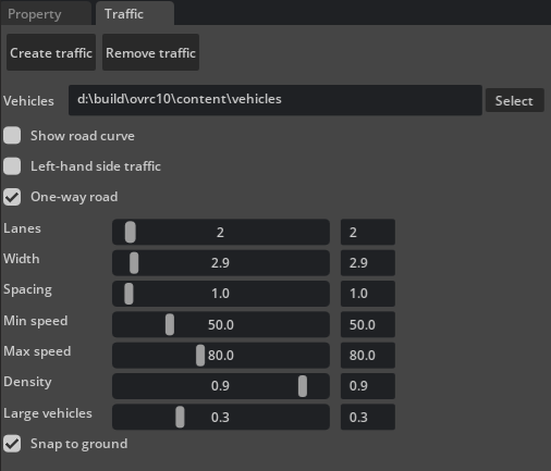

Traffic Parameters
SettingDescription
Create trafficCreate traffic in the path.
Remove trafficDeletes traffic path from the scene.
Show road curveIf checked it shows road curve in the traffic path.
Left-hand side trafficRuns traffic from Left-hand side.
One-way roadIf checked indicates one-way traffic. Unchecked indicates bi-directional traffic flow.
LanesThe number of lanes desired in each direction.
WidthThe lane width in meters or feet.
SpacingOnly applies to bi-directional traffic and indicate the median space between the opposing lanes.
Min & Max speedSets the minimum and maximum speed in either km per hour or miles per hour.
DensitySets the density of traffic along the path.
Large vehiclesYou can adjust the density of the vehicles into the created traffic scene.

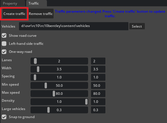

[Note: If traffic parameter changes, Press "Create Traffic" button to update the traffic.]
