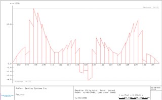

The plot below shows an example of the Balance Cantilever Training, and the Table shows the output used as guidance for the construction.
