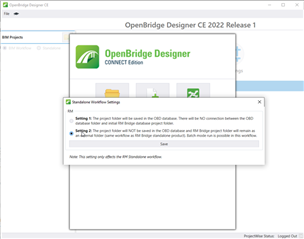

1. OBD > File > Settings
In OBD go to File>Settings and choose the option Settings2.

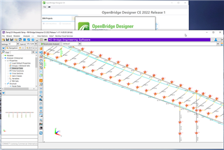

3. Open RM Bridge
With OBD opened for licensing activation purpose, the User can immediately start RM Bridge and work in a completely standalone program version.
4. Direct Access
In the project directory and by double clicking in any *.rm9 file, RM Bridge will be launched automatically and the User will be able to continue the bridge project design.
