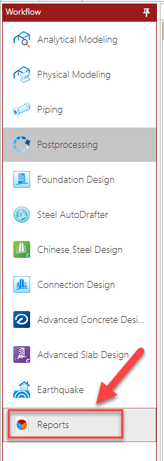

1) Analyze a model and then go to the Reports workflow:

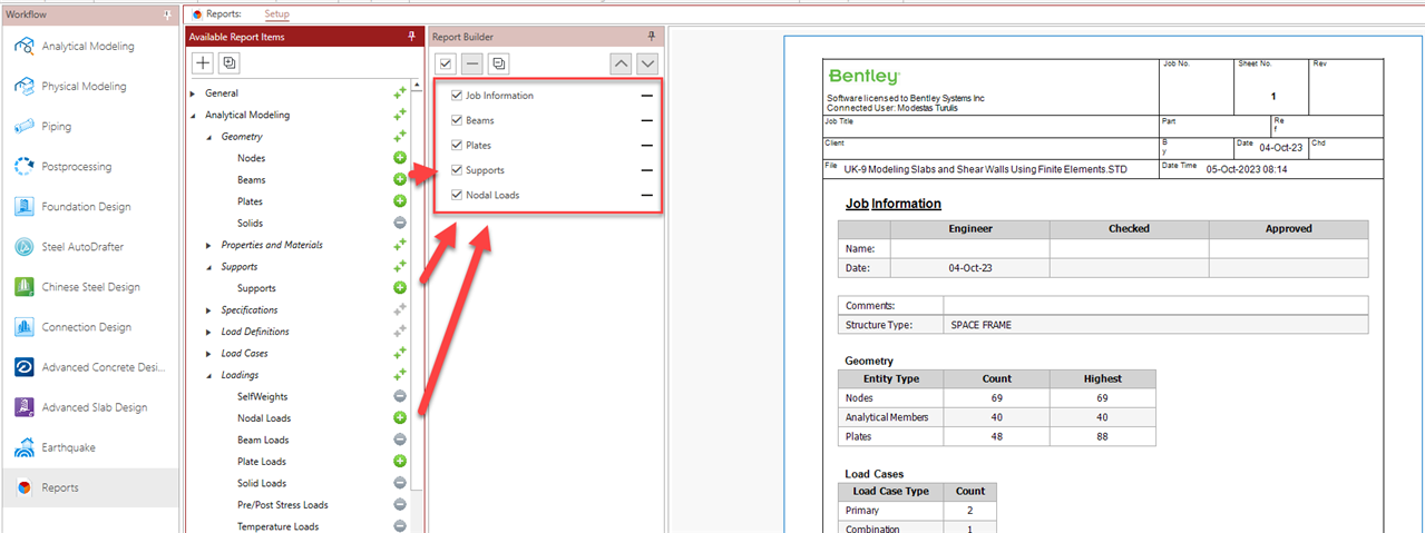

2) Add the required items to the Report Builder list:

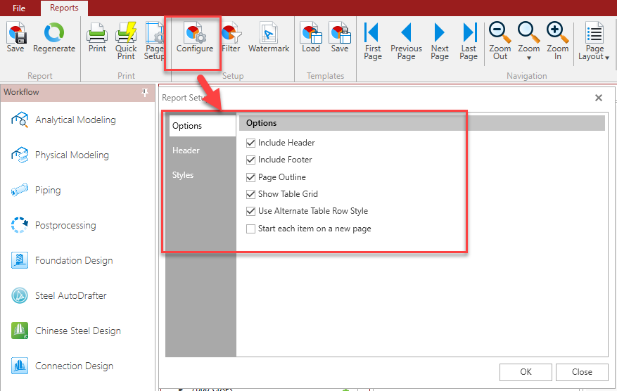

3) If required, change the header, font or some other options in the Configure menu:

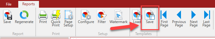

4) On the Reports ribbon tab, select the Save icon in the Templates group:

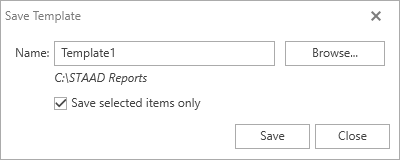

5) In the opened Save Template dialog, provide the template name and a folder where it will be saved and click Save:
To include all items regardless of their selection status, clear the Save selected items only option.

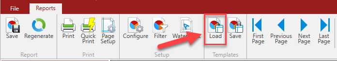

1) In the Reports workflow, select the Load icon in the Templates group:

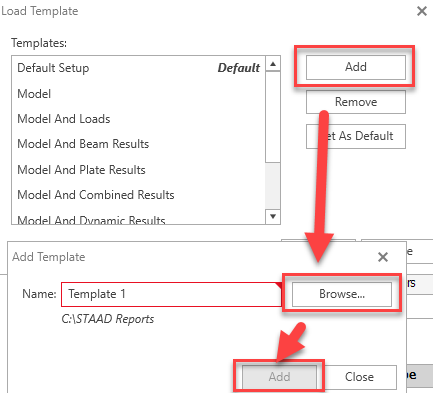

2) In the opened dialog, click Add button and then Browse button to find a created template if it was saved in some non-default folder. Then click Add:

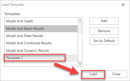

3) Select the required report from the list and click Load:

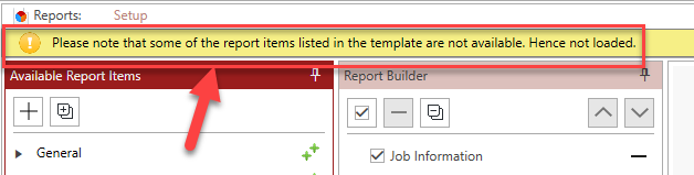

Note: If report items are present in the template but not available in the model, a message is displayed.
