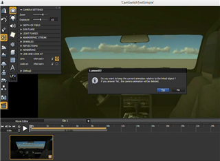

- Now link the camera to the vehicle by going into Setup > Camera > LINK AND LOOK AT.
- Select the link button and choose the vehicle. It will prompt you to keep or discard the current animation. If you keep it, the camera animation (yes), then the camera will be set to always stay a Position relative to the current keyframe and the vehicle. If you select no, then the animation will be created at the beginning of the animation timeline.
- Refresh the keyframe in the timeline. Now when you play the animation, the camera will track inside the vehicle.
