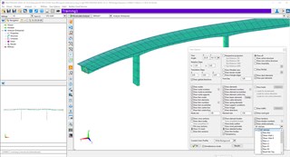

In Main Window, right click in mouse and the following menu is displayed:

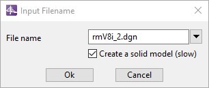

Input the 3D *.dgn file name,

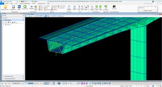

After in OpenBridge Modeler, User has access to all 3D drawing information generated.
