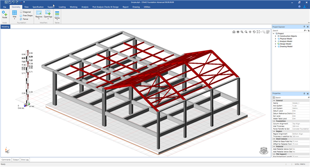

  1. Physical Modelling
STAAD Foundation Advanced 2023 is equipped with physical modelling capabilities for mat foundations to represent the as-built physical object. This includes modelling the pedestals, regions that can be elevated or sunk from the mat surface, openings etc. The user can also model soil and/or pile supported mats. The different modelling tools and assistive prompts in the program help to generate models quickly and efficiently and make the experience with the software more realistic and enjoyable.

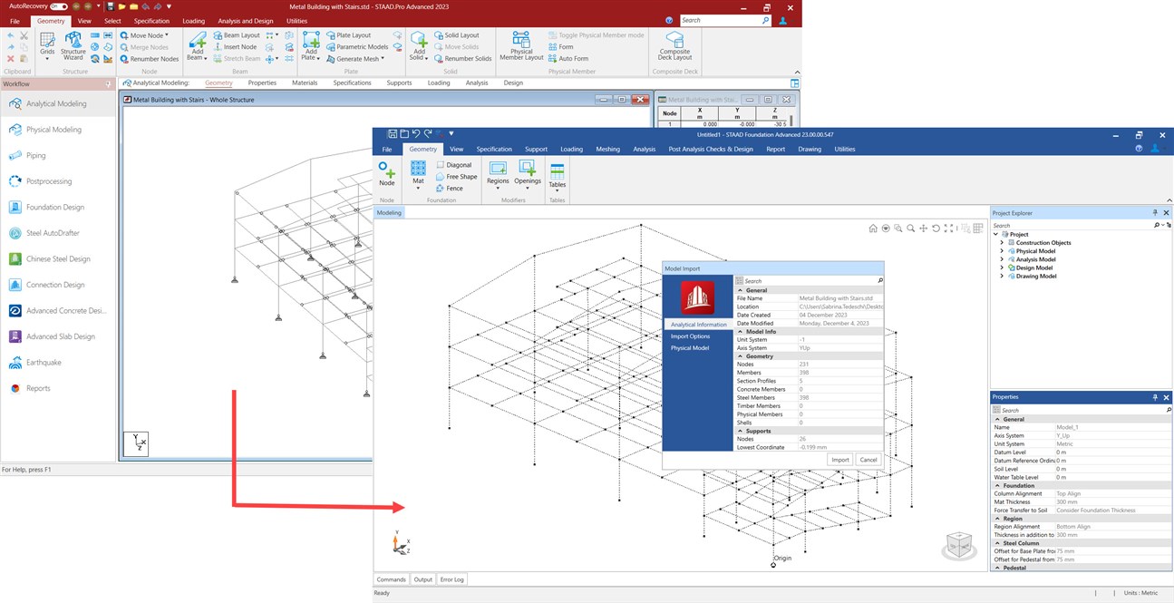

  1. Import of Models
 STAAD Foundation Advanced 2023 can import STAAD.Pro analytical models and stitch the various analytical elements to form a physical model. Structural engineers can use this functionality to model their mats with more accurate references to the imported superstructure. They can now visualize the superstructure and substructure holistically within the same model.
 The feature also includes the import of loads, load combinations, repeat loads and reference loads from the STAAD.Pro model.
 Analytical models of mat foundations created in STAAD.Pro along with any supported superstructure elements can be seamlessly imported into SFA 2023 and converted to physical elements.  The user can then use the existing mat foundation analysis results for design and detailing. This will be extremely useful for the users who intend to consider soil structure interaction in the superstructure analysis.
