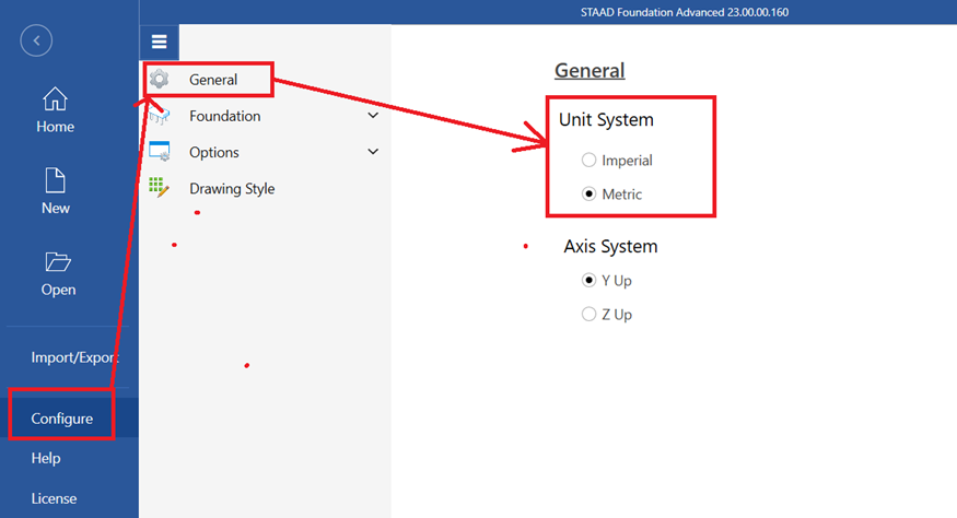

General
 Configure > General option allows the user to set the default Axis System and Unit System. However, the user can change these settings for any specific file he wants to create.

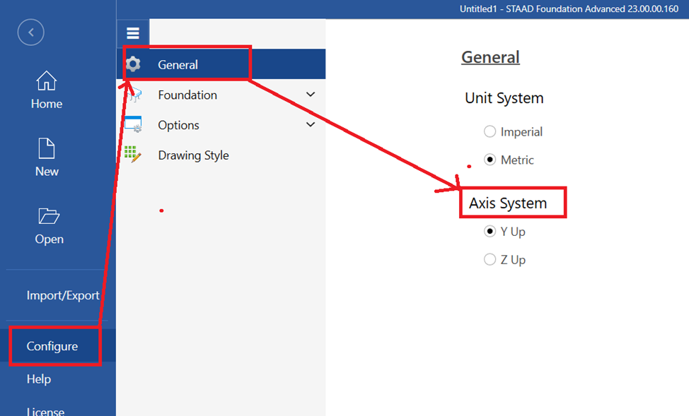

Axis System
There are two global axis systems that are used in the computational analysis and design of structures. One is the Y UP axis system the other is a Z Up axis system. Both the axis systems are shown in Figure 29. The mathematics of the axis systems are explained in details in section # in the Technical Reference manual.
When the user clicks on the “Configure > General” option, he will have the option to choose the radio button corresponding to the Y UP and Z UP option. Refer to below snap, where the Y UP option is chosen by the user. If the user wishes to change the axis system from what he has set as the default one in “Configure” while creating a new file, he can always do that at the start as well.
Unit System
Like the Axis System the default unit system can also be set from the “Configure > General” option. There are two available unit systems – (1) Imperial and (2) Metric. If the user chooses the Imperial system, the basic units of force and distance and all derived units from it will be in English units. If the user chooses to use Metric, the same will be in metric units. In above figure, the user chose his default unit system in “Metric”. However, he can choose to change the default settings for any specific file as well at the start of creating that file.
Please note that there is an “Update” button at the bottom of the screen which becomes active if the user clicks on a different axis system or a unit system than the one shown in the screen based on the program default settings or the last user specified default settings.

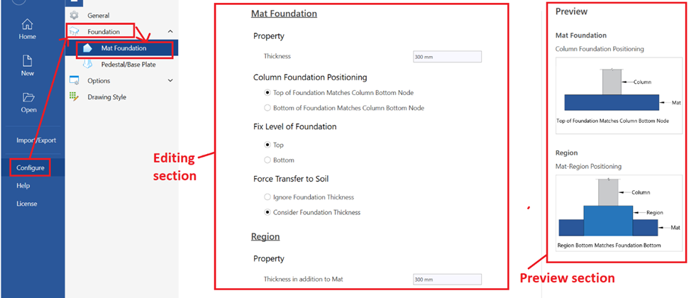

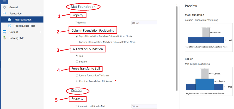

Mat Foundation
When the user chooses this option, the default mat foundation settings are displayed as shown in the below figure. The sequence of clicks to access this option is indicated by the arrow symbols. There are two main areas – (1) Editing section, where the user actually sets the default settings for the mat (2) the other is the preview section where the user can see with the help of illustration the physical interpretation of specific settings.
Each of the default settings in the “Editing” or “Setting” section is discussed in detail along with Figure below.
  1. Mat Foundation – Property:
The only item under property is “Thickness”. The edit box corresponding to “Thickness” is used to define the default thickness of the mat. The thickness needs to be specified in the unit system that has been defined for the file that the user intends to work on. In metric units the program will set the value of 300 mm for the thickness while it will set 12 inches thickness in imperial units. The user can choose to set his own default value.

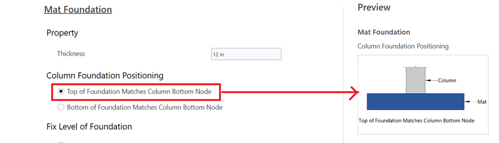

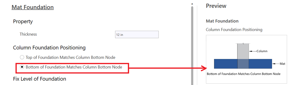

  1. Mat Foundation - Column Foundation Positioning
If columns are to be supported by a mat foundation, there can be two possible ways to consider the load transfer from the column to the mat, in the program currently.

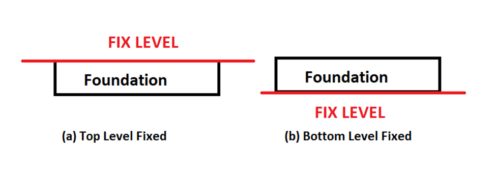

  1. Mat Foundation - Fix Level of Foundation
 “Fix Level” indicates the level where the foundation dimensions are fixed. There are two options for this setting – “Top” and “Bottom”.
 If the user specifies “Top” option, this indicates that thickness specified will go down from this level. In the Application page, when the user creates the mat, he will need to define the top level. The finite element mesh for analysis will also be created at this level.
 If the user specifies “Bottom” the thickness will go up from this level. In the Applications Page, the user will need to define the bottom level of the mat. The finite element mesh will also be created at the bottom level. Please refer to below snap.

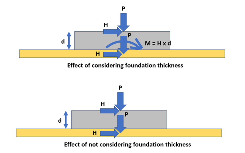

  1. Mat Foundation – Force Transfer to Soil
This setting wants the user to specify how the program should consider the default way of transferring horizontal force from the foundation to the soil if the force is transferred from the top of the foundation. The user is asked to specify if he would like to consider the foundation thickness while transferring the load. If so, he needs to click the radio button besides “Consider Foundation Thickness”. If the foundation thickness is considered, then the program will consider by default, one additional moment created by a horizontal force being applied to the top of the foundation. If the user wishes the program to consider, by default, only the horizontal force and disregard the moment created due to thickness of foundation he needs to click the radio button corresponding to “Ignore Foundation Thickness”. Please refer to below snap which illustrates this.

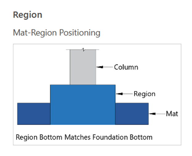

  1. Region – Property
If a region needs to be modelled for additional thickening of the mat the user needs to specify the additional thickness over the mat thickness specified. This setting wants the user to specify the default value of the additional thickness that needs to be considered. The program considered additional thickness is 12 in if the unit setting is imperial and 300 mm if the unit setting is metric.
Also, please note the illustration of the mat and the region in the “Preview section” for a clearer understanding of the difference. This is again reproduced in below snap.

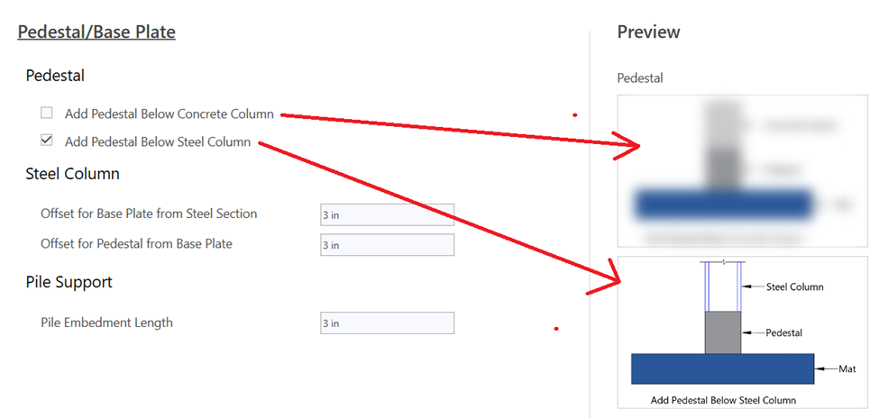

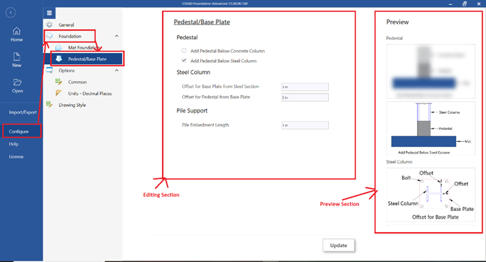

Pedestal / Base Plate
Like the “Mat Foundation” option as described above, the Pedestal / Base plate option also has been divided into the “Edit” section and “Preview” section. This is shown in below snap. In the Edit section, the user can specify the requisite default values that he wants to use in the program related to pedestal and base plate. Below snap also shows the sequence of clicks using the arrow lines to access this option.
Each of the options in the editing section is discussed in further detail below with reference to below snap.
  1. Pedestal/Base Plate – Pedestal
This option is meant for the user to specify if he would like to consider pedestal below his concrete or steel columns by default. There are two options here – (1) Add Pedestal Below Concrete Column (2) Add Pedestal below Steel Column. The user can choose either one or both of these options. This will make the program automatically model pedestals below columns if the level of the bottom of the column is not the same as the top of the foundation leaving a gap in between.
This option is also illustrated in the “Preview” section as showed in below snap. Note how the illustration corresponding to “Add Pedestal below Concrete Column” has been blurred out as this option is not chosen. The illustration will be as clear as the “Add Pedestal below Steel Column” if we choose this option.

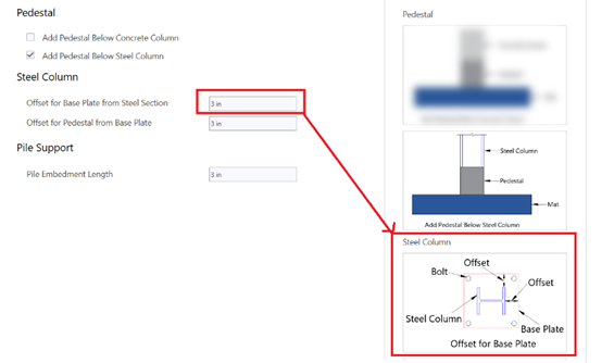

  1. Pedestal / Base Plate – Steel Column
The default surface area of the base plate and the pedestal, on which the base plate will rest, will depend on the two units in this section. The users are expected to provide the default offset values for (1) Base Plate from steel section. This will help determine the surface area of the base plate. This is illustrated in the preview section as shown in below snap. The default machine value is 3 inches for imperial units and 76.2 mm for the metric units (2) Pedestal from base plate. This will help determine the surface area of the pedestal on which the base plate will rest. The default machine settings in 3 inches for imperial units and 76.2 mms for the metric units.
Please note that the pedestal surface area on which the concrete column will be formed will be same as the cross-sectional area of the column.
  1. Pedestal / Base plate – Pile Support
This option allows the user to specify the default value for the pile embedment length. This is the length by which the pile will go into the mat foundation for piled mat foundation or pile caps. The machine provided default value is 3 inches for imperial units and 76.2 mms for metric units.

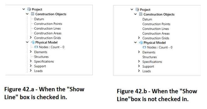

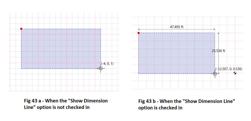

Construction Preview:
This option has a check box titled “Show Dimension Line”. If this option is checked in, the dimension line is displayed while creating the mat. Below snap shows the difference between having this option checked in and not checked in.

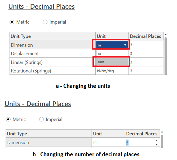

“Units – Decimal Places”
            This option allows the user to set the default units and the default number of decimal places for various parameters (like dimensions, displacements, spring stiffness etc.), relevant to a specific unit system in the file. By default, it displays the same for the unit system that is set in Configure > General option, as discussed in section above. However, the user can change it if necessary.
The user will need to click on the “Unit” column to change the default units in a unit system. A drop down will allow the user to make the change. For example, in below snap – the user is intending to change the default unit for “dimensions” – from meter to mms for the metric unit system.
A preview option, on the right side of the screen will display details, if any, about the parameter chosen.
Similarly, an “up and bottom” switch in the “Decimal Places” column, as shown in below snap – will allow the user to change the default number of decimal places for each parameter displayed. To increase the number of decimal places one needs to click on the “up” switch and to reduce the number of decimal places, one should click on the “down” switch. By default, all the parameters are set to be displayed in three decimal places.
