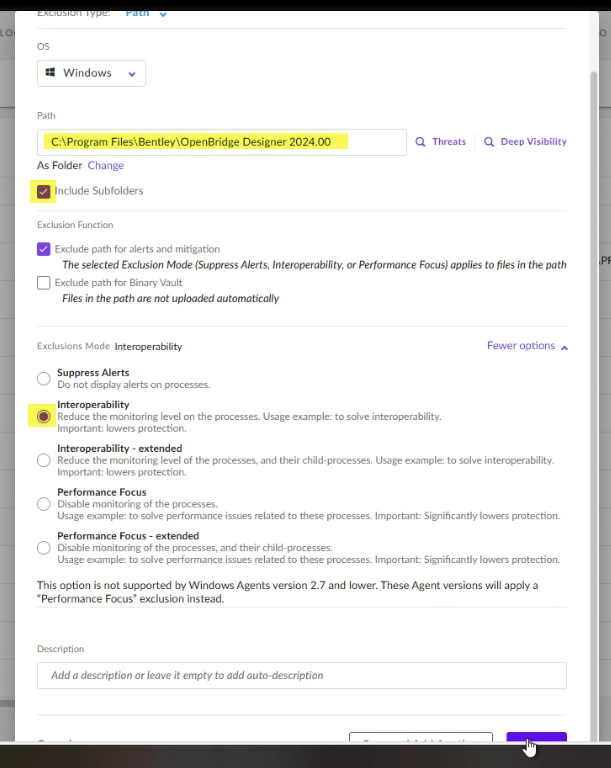

PROBLEM:  Able to create new OBD file and also create new LEAP Bridge Concrete models but getting a Database Reading Error when opening then again.
RESOLUTION: You can whitelist the entire path along with the subfolders with exclusion model set to Interoperability or you can whitelist the executables (EXE) files for each component.
Please check if you have Sentinel One for Antivirus.  Whitelist the following EXE files in Sentinel One for OpenBridge Designer applications to resolve the issue:

Sentinel One Whitelisting And Blacklisting
