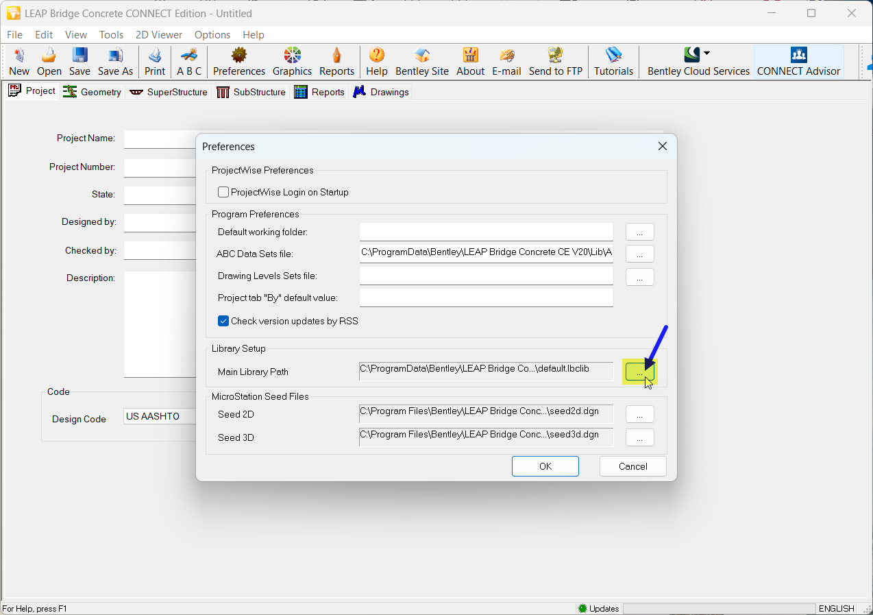

Where is the consolidated library of LEAP Bridge Concrete located?
If the user needs to re-point to the consolidated library of LEAP Bridge Concrete, follow the path:
Options/Preferences/Main Library Path button (see screen shot below).
User needs full control on the path below:
C:\ProgramData\Bentley\LEAP Bridge Concrete CE V20\Lib
For LBC inside OBD check the link below:
communities.bentley.com/.../where-is-the-lbc-default-library-located
