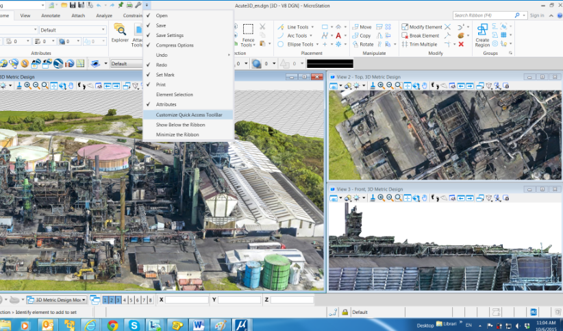

This CONNECT Edition has a Ribbon now, so this version has no pulldown menus anymore.
The ribbon tabs and the ribbon backstage should provide access to all of the commands that were available in the menu in older versions of MicroStation.

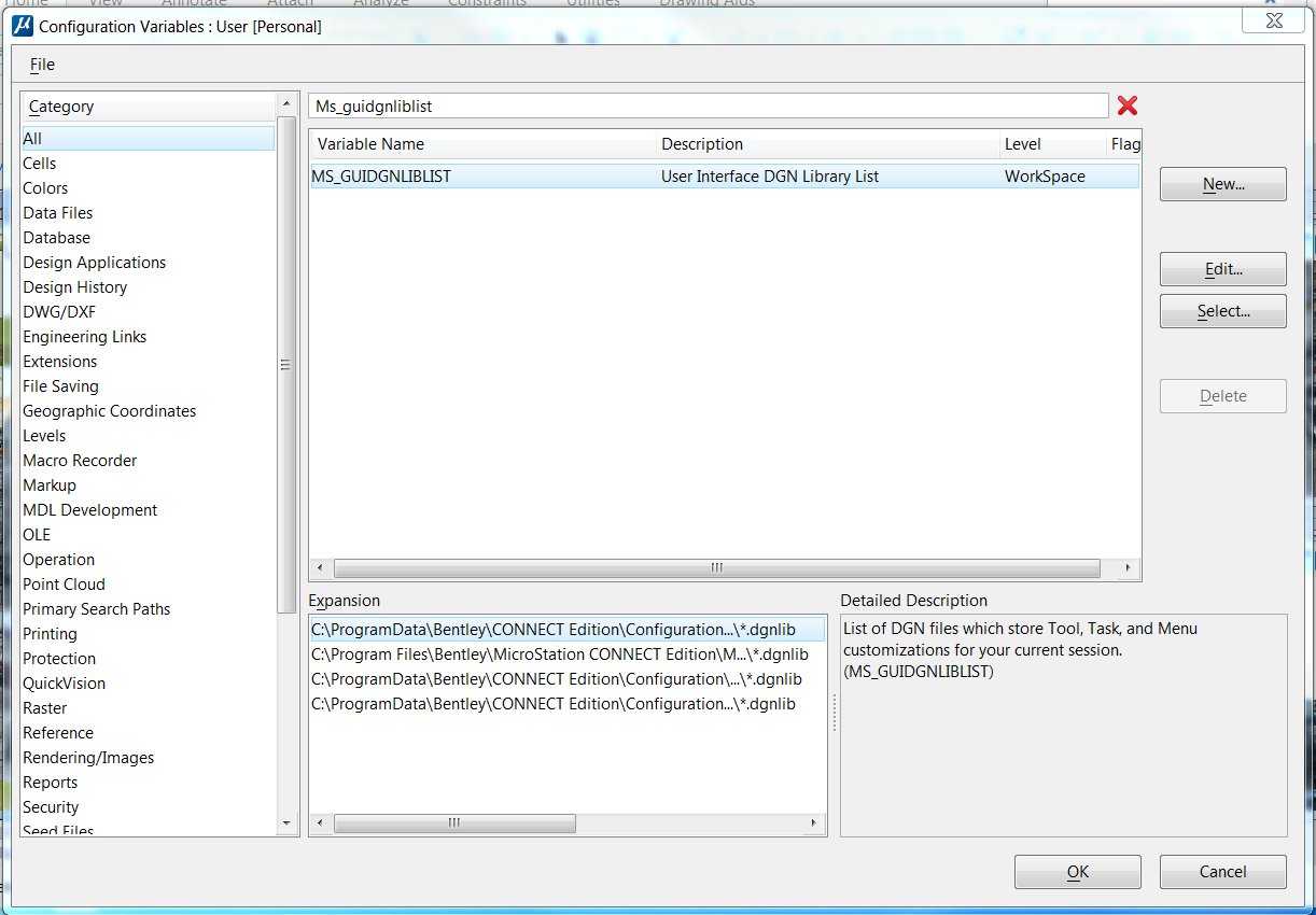

If your Dgnlib is defined in MS_GUIDGNLIBLIST variable:
Please have a look at the video below if you want to create a customized ribbon from scratch:
You can also open any DGNLIB that is in the MS_GUIDGNLIBLIST, and any customizations will be stored in that DGNLIB file. The DGNLIB where the customizations are stored is shown in the title bar of the "Customize Ribbon" dialog.
MS_PERSONALDGNLIB is used when any DGN/DWG file is open, this variable points to personal.dgnlib in the same folder as your upf file.
