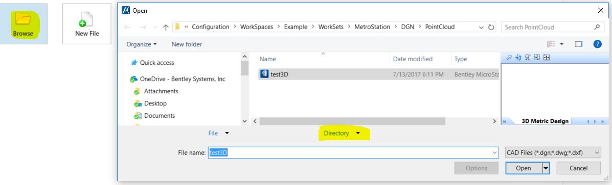

In the CONNECT Edition, there are 2 areas where you can find the Directory history
1. Click to "Browse" > Open dialog > Directory
2. Click to "New" > New dialog > icon "Directory History"
