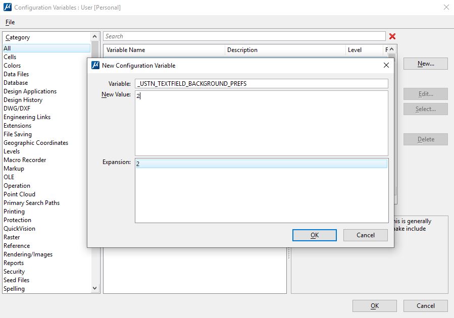

  1. Included in MicroStation CONNECT Edition (Update 13) is a new configuration variable that can be used to either suppress the display of the grey background or to use the selected Text Style settings including its background color.
    _USTN_TEXTFIELD_BACKGROUND_PREFS
    1. If variable is set to 0 then both check boxes are off
    2. If variable is set 1 then Hide Field Background checkbox is checked.
    3. If variable is set 2 then both Hide Field background as well as Apply Field Background from Text style is checked and enabled.
  2. Open the Configuration Variable dialog to make changes to this configuration variable. If you select to add a "New" variable with this it may advise that it is already defined as [Null] and ask whether you want to change the setting.
