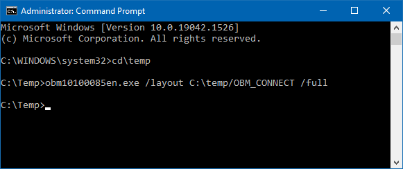

- Open Admin command prompt and navigate to where the “obm10100085en.exe" resides (in our example to “C:\Temp\”) and run the command as shown:
C:\Temp>obm10100085en.exe /layout C:\temp/OBM_CONNECT /full
This will start the download process of all the installation files:

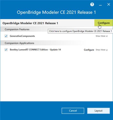

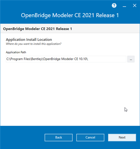

- (Optional) To make changes to the default OpenBridge Modeler Configuration click on "Configuration"
![](96bf2285478a8a1488c56642846d4312.iix)

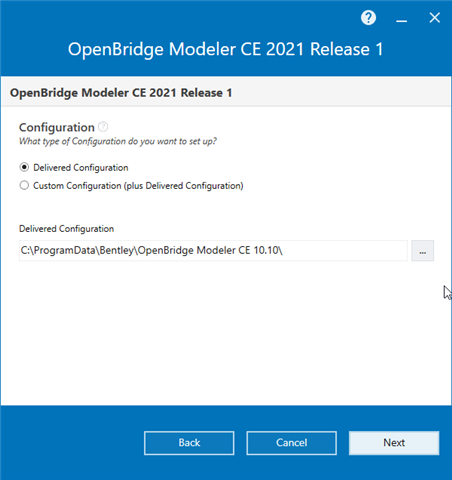

- To change the path of delivered Configuration, click the Browse button next to the Configuration Path field.
In the Browse For Folder dialog that opens, browse to the drive and folder where you want to deliver the default Configuration, then click OK.
![](aabf6249470ac614e3378d53636d43ee.iix)
- To set up custom or shared Configuration, select the Custom Configuration (plus Delivered Configuration) radio button. Then click the Browse button next to the Network Configuration field.
In the Browse For Folder dialog that opens, browse to the drive and folder where your custom Configuration is located, then click OK.
![](7ebfe249470ac614e3378d53636d4320.iix)

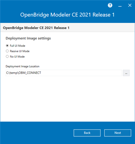

- Click Next. The Deployment Image Settings page opens.
- Change the deployment image setting.
By default, Passive UI Mode is selected.
![](43bfaa09470ac614e3378d53636d4369.iix)

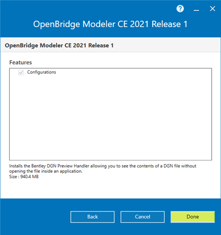

- Click on Next and then Done to accept the configuration settings:
![](83bfe249470ac614e3378d53636d4378.iix)

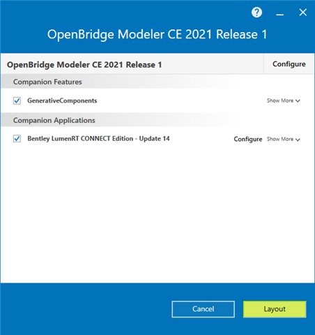

- Finally click on Layout to start the download process of all the installation files:
![](17bf2285478a8a1488c56642846d4317.iix)
- To install the OBM version navigate to the C:\temp/OBM_CONNECT folder and launch "Setup_OpenBridgeModelerx64_10.10.00.085.exe".
