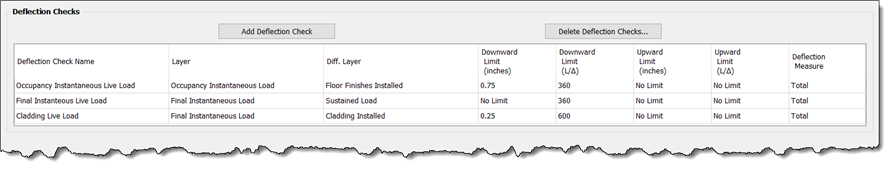

Deflection Check criteria must be specified in the Deflection Check Table (Criteria > Deflection Checks) before deflection limits are checked during the design calculations.
Figure 1. Deflection Check Table
To add a Deflection Check to the table, click on the Add Deflection Check button, enter the information below in the dialog, and then click OK.
After a Deflection Check is added, deflection limits can be specified in the Deflection Check Table.
Deflection limits are defined using the properties described in the list below. When defining the upward or downward deflection limit properties, a value can be input in the table or No Limit may be selected.
Downward Limit - downward deflection limit defined as an absolute deflection.
Downward Limit (L/Δ) - downward deflection limit defined as a proportion of the span length.
Upward Limit - upward deflection limit defined as an absolute deflection.
Upward Limit (L/Δ) - upward deflection limit defined as a proportion of the span length.

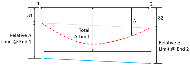

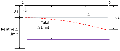

Deflection Measure - how the deflection is measured, which can be Total or Relative. Total deflections are measured from the undisplaced shape. Relative deflections are measured relative to the displacements at the end of a span or check line. See figures below for a summary of each option.
 Figure 2. Deflection Check Measures for Typical Span
Figure 3. Deflection Check Measures for Span with Support at One End (Point 1)

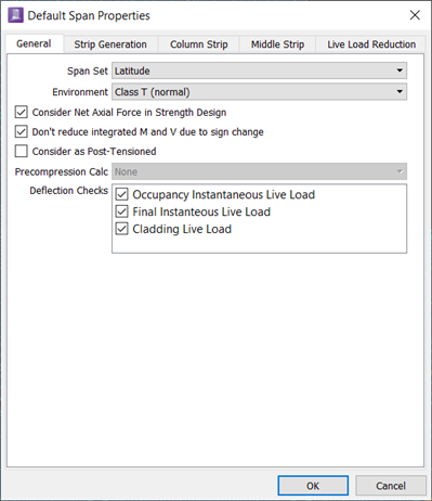

To assign one or more Deflection Checks to a span segment, check the boxes next to the appropriate Deflection Check listed in the Deflection Check box in the General tab of the Span Segment property dialog.

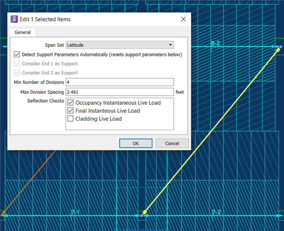

Deflection Check Lines are new RAM Concept objects that designed exclusively for deflection checks. Like span segments, they are typically modeled between supports, most often diagonally across a given bay as shown in the image below. Deflection Check Lines are also useful for checking deflections at localized areas away from supports, for example at slab edges or at transfer loads.
Deflection Check Lines are modeled on the Design Strip Layer and grouped by Latitude and Longitude Span Sets similar to span segments. To model a Deflection Check Line, do the following:
  1. Choose Tools > Deflection Check or click the Deflection Check Tool
  2. Click at the deflection line start point.
  3. Click at the deflection line end point. The two clicks (Step 2 and Step 3) define the deflection line spline.
To assign one or more Deflection Checks to a deflection check line, check the boxes next to the appropriate Deflection Check listed in the Deflection Check box in the General tab of the Deflection Check Line property dialog.

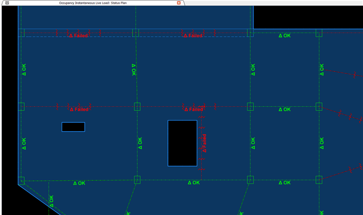

When a Deflection Check is defined, a Status Plan, Deflection Checks Plan, and a Std Deflection Plan are automatically generated for the check on the Deflection Checks Layer.
The Status Plan displays the spline line for each deflection check line and span segment with a deflection check assignment. After the calculations are run, these lines are displayed in green with a status of “Δ OK” if the calculated limits are within the defined deflection limits. When the calculated deflection i outside the defined deflection limits, the lines are displayed in red with a status of “Δ Failed.” Failure locations are marked across the spline line. If a Deflection Check references a load history layer and the analysis is completed without the load history calculations, “Δ Needs Calc” will be displayed for the status. Results will be displayed after the load history calculations are completed.

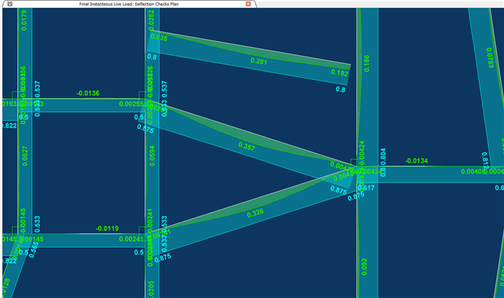

The Deflection Checks Plan displays the calculated deflection and deflection limit for each deflection check line and span segment with a deflection check assignment. Plotted results represent the envelope results for the layers defined with the Deflection Checks. No information will be displayed in this plan if the check references a load history layer and the analysis is completed without the load history calculations.
Figure 7. Deflection Check Layer - Deflection Checks Plan
